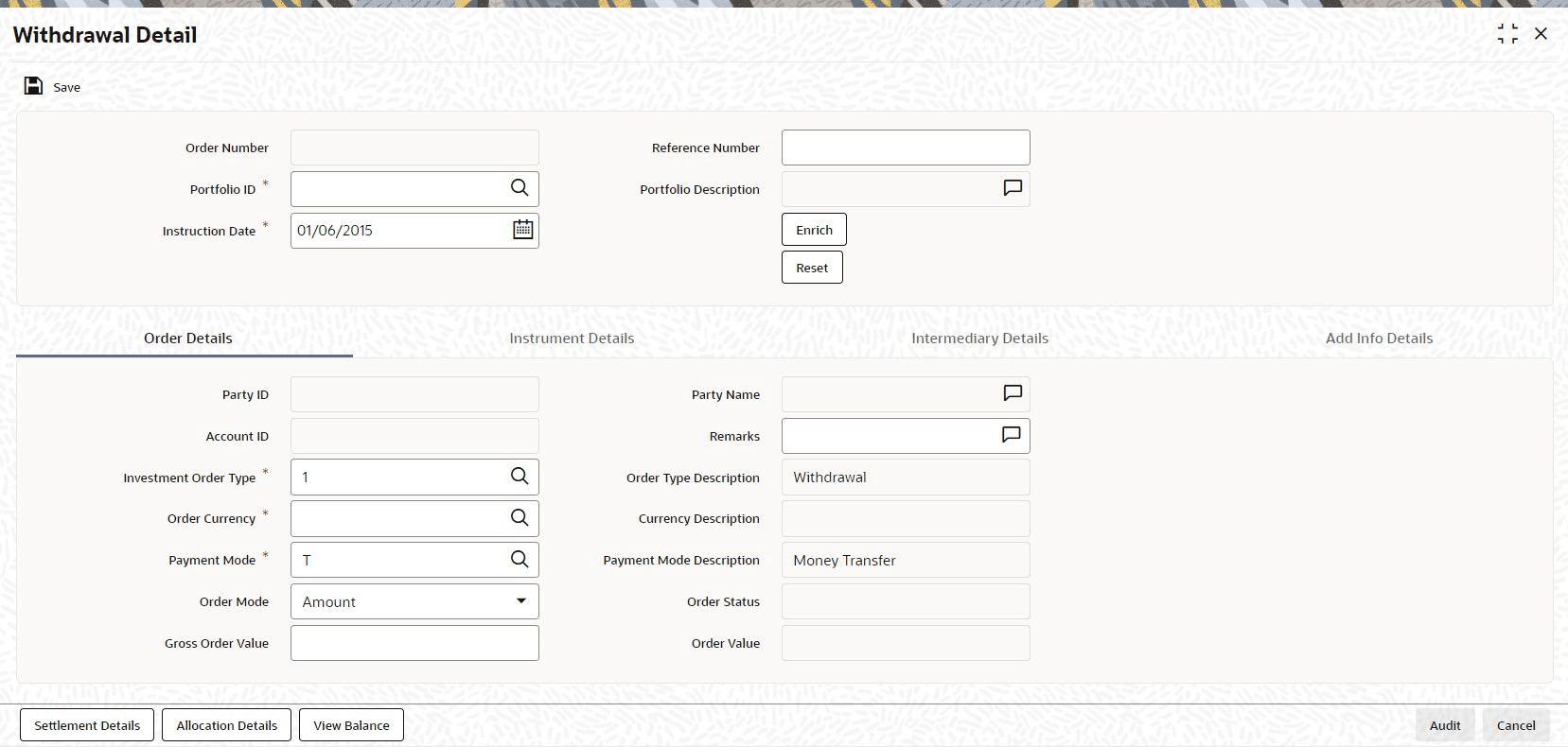

1.62.1 Order Details Tab
This topic explains the Order Details of Withdrawal Detail screen.
- On Withdrawal Detail screen, click Order Details tab to view the following details.The Order Details are displayed.
- On the Order Details tab, specify the fields.For more information on fields, refer to the field description table.
Table 1-86 Order Details - Field Description.
Field Description Party ID Display The system displays the party ID based on the portfolio ID selected.
Party Name Display The system displays the name of the party based on the portfolio ID selected.
Account ID Display The system displays the account number of the party based on the portfolio ID selected.
Remarks Alphanumeric; 255 Characters; Optional Specify remarks, if any.
Withdrawal Order Type Alphanumeric; 3 Characters; Mandatory Specify the withdrawal order type. Alternatively, you can select withdrawal order type from the option list. The list displays Withdrawal order type maintained in the system.
The system uses PASWDTXNSUBTYPE param code to maintain the withdrawal order type.
Order Type Description Display The system displays the description of the selected withdrawal order type.
Order Currency Alphanumeric; 3 Characters; Mandatory Specify the order currency code. Alternatively, you can select the currency code from the option list. The list displays all valid currency code maintained in the system.
Currency Description Display The system displays the description of the selected order currency code.
Payment Mode Alphanumeric; 2 Characters; Mandatory Specify the payment mode. Alternatively, you can select the mode of payment from the option list. The list displays all valid payment mode maintained in the system.
Payment Mode Description Display The system displays the description of the selected mode of payment.
Order Mode Optional Select the order mode from the drop-down list. The list displays the following values:
- Amount
- Percentage
Gross Order Value Numeric; 30 Characters; Mandatory Specify the gross order value for withdrawal.
Order Value Display The system displays the net amount.
The system calculates the order value as follows:
Order Value = Gross Order Value
Order Status Display The system displays the status of the order.
