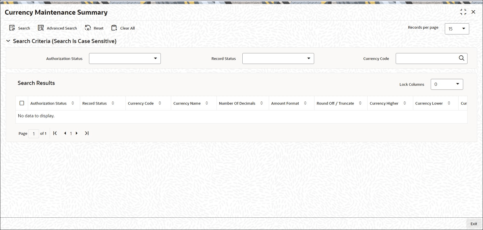

Retrieve Currency Record
  1. On Home screen, type UTSCURMA in the text box, and click Next.
    The Currency Maintenance Summary screen is displayed.
    Figure 5-2 Currency Maintenance Summary
  2. On Currency Maintenance Summary screen, specify any or all of the following details in the corresponding fields:
    • Authorization Status - If you choose the status, then the records matching the specified status are retrieved. If you do not choose any option, then all the records are retrieved.
    • Record status
    • Currency Code
  3. Click Search button to view the records.
    All the records with the specified details are retrieved and displayed in the lower portion of the screen.
