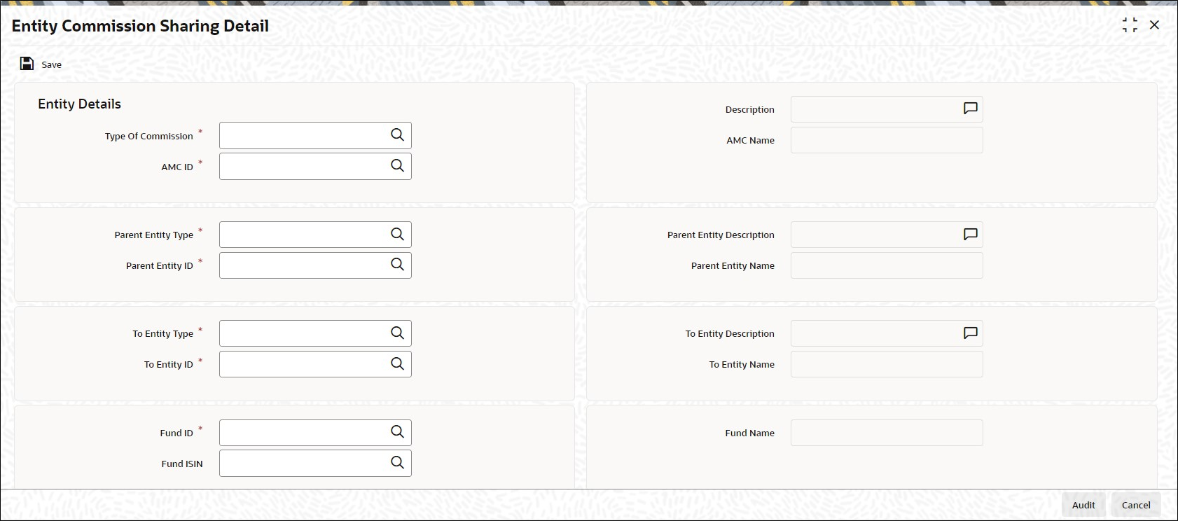

- On Home screen, type
UTDENTCO
in the text box, and click Next.The Entity Commission Sharing Detail screen is displayed.
Figure 7-23 Entity Commission Sharing Detail
- On Entity Commission Sharing Detail screen, click
New to enter the details.For more information on fields, refer to the field description table.
