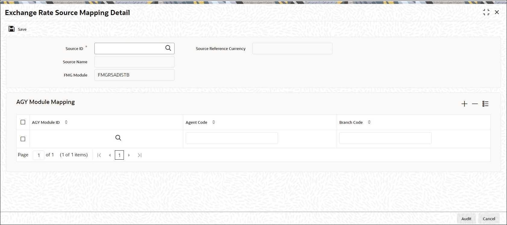

Exchange Rate Source Mapping Detail
  1. On Home screen, type UTDEXRMP in the text box, and click Next.
    The Exchange Rate Source Mapping Detail screen is displayed.
    Figure 7-10 Exchange Rate Source Mapping Detail
  2. On Exchange Rate Source Mapping Detail screen, click New to enter the details.

    Source ID Alphanumeric; 6 Characters; Mandatory
    Specify the source ID across schema will be available for mapping. Alternatively, you can select the source ID from the option list. The list displays all valid source ID maintained in the system.
    Source Name Display
    The system displays the source name for the selected source ID.
    Source Reference Currency Display
    The system displays the source reference currency code.
    FMG Module Display; Alphanumeric; 30 Characters
    The system displays the current logged in FMG Module.
    AGY Module Mapping
    AGY Module Mapping is used to map the required exchange rate sources to one or more AGY modules of the Fund manager. It includes the following fields.
    • AGY Module ID
    • Agent Code
    • Branch Code
    Note: If there is no module mapped in AGY Module Mapping section, then the entity will be listed in all Agency branches of the mapped Fund Manager.
    If there is any module mapped in AGY Module Mapping section, then the entity will be listed only in the mapped Agency branch of the mapped Fund Manager.
    AGY Module ID Alphanumeric; 30 Characters; Mandatory
    Specify the AGY module ID. Alternatively, you can select the AGY module ID from the LOV. The list displays the same maintained in the system.
    Agent Code Display
    The system displays the default agent code for the selected AGY Module ID.
    Branch Code Display
    The system displays the default branch code for the selected AGY Module ID.
