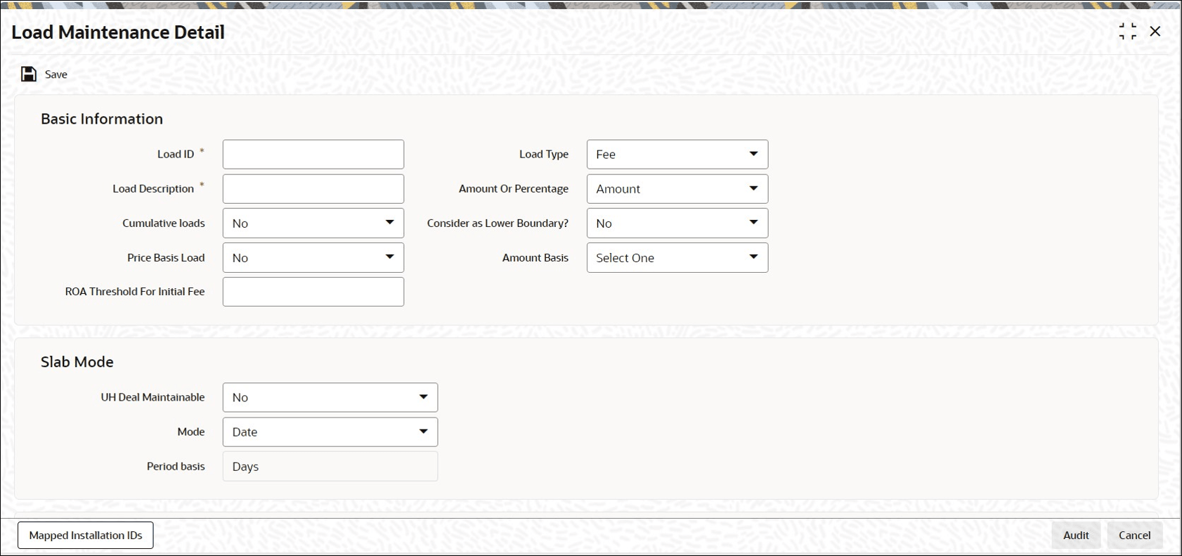

Use Load Maintenance Detail screen to enter cut off time for currencies.
  1. On Home screen, type UTDLOADM/ UTDLODM in the text box, and click Next.
    The Load Maintenance Detail screen is displayed.
    Figure 7-1 Load Maintenance Detail

  7. On Load Maintenance Detail screen, click New to enter the details.
    Table 7-1 Load Maintenance Detail - Field Description
