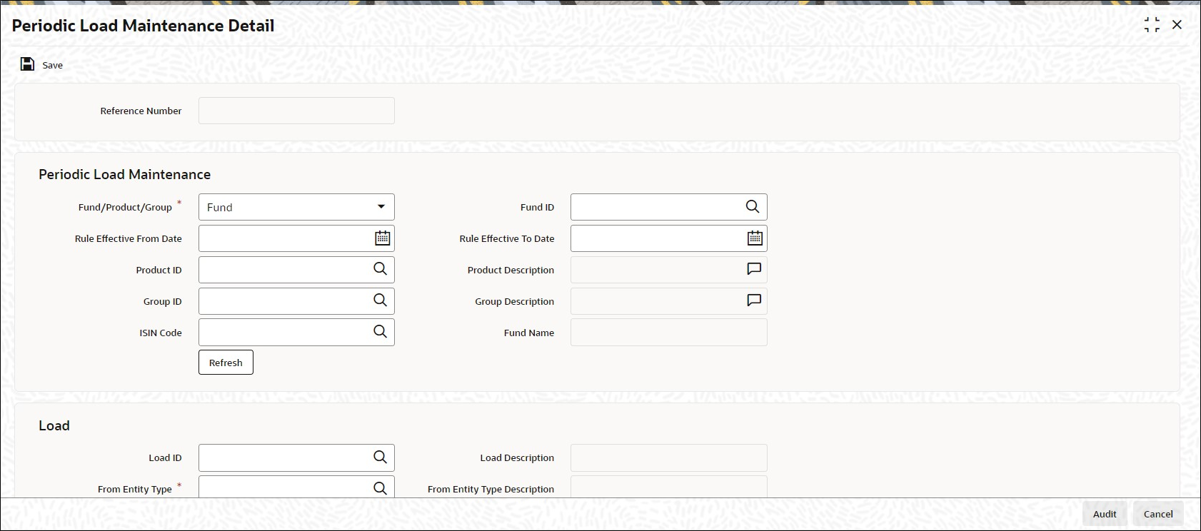

7.10 Process Periodic Load Maintenance Detail
This topic provides the systematic instructions to maintain periodic loads.
- On Home screen, type
UTDPERLM
in the text box, and click Next.The Periodic Load Maintenance Detail screen is displayed.
Figure 7-17 Periodic Load Maintenance Detail
- The Periodic Load Setup screen facilitates the mapping
of the trailing fee (load) to a fund, and setting up the following details
regarding the fee:
- The period in respect of which the trailing fee is to be computed.
- The From and To entities in respect of which the trailing fee will be paid out/received
- The frequency at which the trailing fee is processed
- The computation method (nature) of the fee
- The event of application or action of the fee
- The last processed date and the next date on which the fee must be processed
- The number of decimals for the load

- On Periodic Load Maintenance Detail screen, click
New to enter the details.For more information on fields, refer to the field description table.
Table 7-15 Periodic Load Maintenance Detail - Field Description
Field Description Reference Number Display The system displays the reference number.
Periodic Load Maintenance If you are defining the periodic fee to be applicable for a product, you must define the specific funds and /or groups in the product portfolio to which the fee would be applied. When you select the product in the Fund/Product/Group ID field, any groups or funds that are mapped to the product portfolio are displayed in these sections.
To specify the funds or groups to which the fee must be applicable, use the arrow buttons to move the selected funds or groups from the Available Portfolios / Available Groups boxes to the Mapped boxes.
Note: It is mandatory that you map all available portfolios to the groups.
Fund/Product/Group Mandatory You can use this field to indicate whether the periodic fee is being set up to be applicable for a fund, a product or a group. The drop-down list displays the following values:- Fund
- Product
- Group
Fund ID Alphanumeric; 12 Characters; Mandatory Specify the fund ID.
Rule Effective From Date Date Format; Mandatory By specifying the two dates, indicate the period in respect of which the trailing fee computation must be arrived at.
The system will allow backdating the periodic load Rule effective date for new loads for a fund. For funds where there is no load attached; a new load can be created with ‘Rule Effective Date’ as back date. This date cannot be less than the ‘First price declare date’ and ‘fund rule effective date’.
Rule Effective To Date Date Format; Mandatory Specify the period in respect of which the trailing fee computation must be arrived at.
Product ID Alphanumeric; 12 Characters; Optional Specify the product ID.
Product Description Display The system displays description for the specified product based on the details maintained for at Product Fund Maintenance level.
Group ID Alphanumeric; 12 Characters; Optional Specify the group ID.
Group Description Display The system displays description for the specified group based on the details maintained for at Payment Group Maintenance level.
ISIN Code Alphanumeric; 12 Characters; Optional Specify the ISIN Code for the periodic fee.
If you specify ISIN code then system displays the fund ID and vice versa.
Fund Name Display only The system displays description for the specified fund based on the details maintained for at Fund Maintenance level.
Click Refresh button to refresh the details.

Threshold on Ongoing Fee Alphanumeric; 30 Characters; Optional Specify threshold amount for ongoing fees, if the load type mapped is ‘ROA’ load.
The system compares the value specified with the cumulative AUM of the client to determine the Trailer fees to be charged.
Trailer Comm Aum Slab Basis Mandatory Select a valid basis system to pick up AUM to determine the trailer commission load slab from the drop-down list. The list displays the following values:- UH-Product-Policy-Fund-Level
- UH-Product-Policy-Level
- UH-Product-Level
- UH-Level
- CIF- Product-Level
- CIF- Level
You can not change the AUM basis specified for trailer commission in the accrual cycle after it is defined.
Fund Load Details The section displays the following fields. Fund ID Alphanumeric; 12 Characters; Mandatory Specify the fund id. The adjoining option list displays valid fund ids maintained in the system. You can choose the appropriate one.
Load ID Numeric; 22 Characters; Optional Specify the load id. The adjoining option list displays valid load ids maintained in the system. You can choose the appropriate one.
Management Fee Load ID Numeric; 22 Characters; Optional Specify the load id of the management fee. The adjoining option list displays valid management fee load IDs maintained in the system. You can choose the appropriate one.
Transaction Category The section displays the following fields. Transaction Category Alphanumeric; 1 Character; Mandatory Specify the transaction category. Alternatively, you can select transaction category from the option list. The list displays all valid transaction category maintained in the system.
Description Display The system displays the description for the selected transaction category.
Parent topic: Set up Loads
