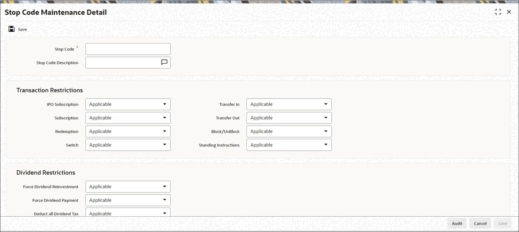

  1. On Home screen, type UTDSTOPC in the text box, and click Next.
    The Stop Code Maintenance Detail screen is displayed.
    Figure 3-18 Stop Code Maintenance Detail
  2. On Stop Code Maintenance Detail screen, click New to enter the details.
