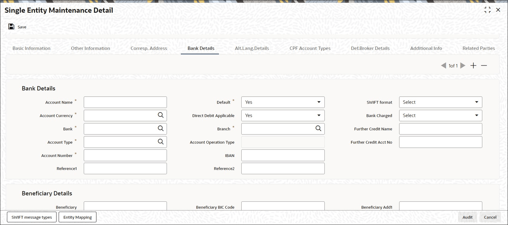

- On Single Entity Maintenance Detail screen, click Bank Details tab to capture the bank details.The Bank Details are displayed.
Figure 2-7 Single Entity Maintenance Detail_Bank Details Tab
- On Bank Details Tab, specify the fields.For more information on fields, refer to the field description table.
