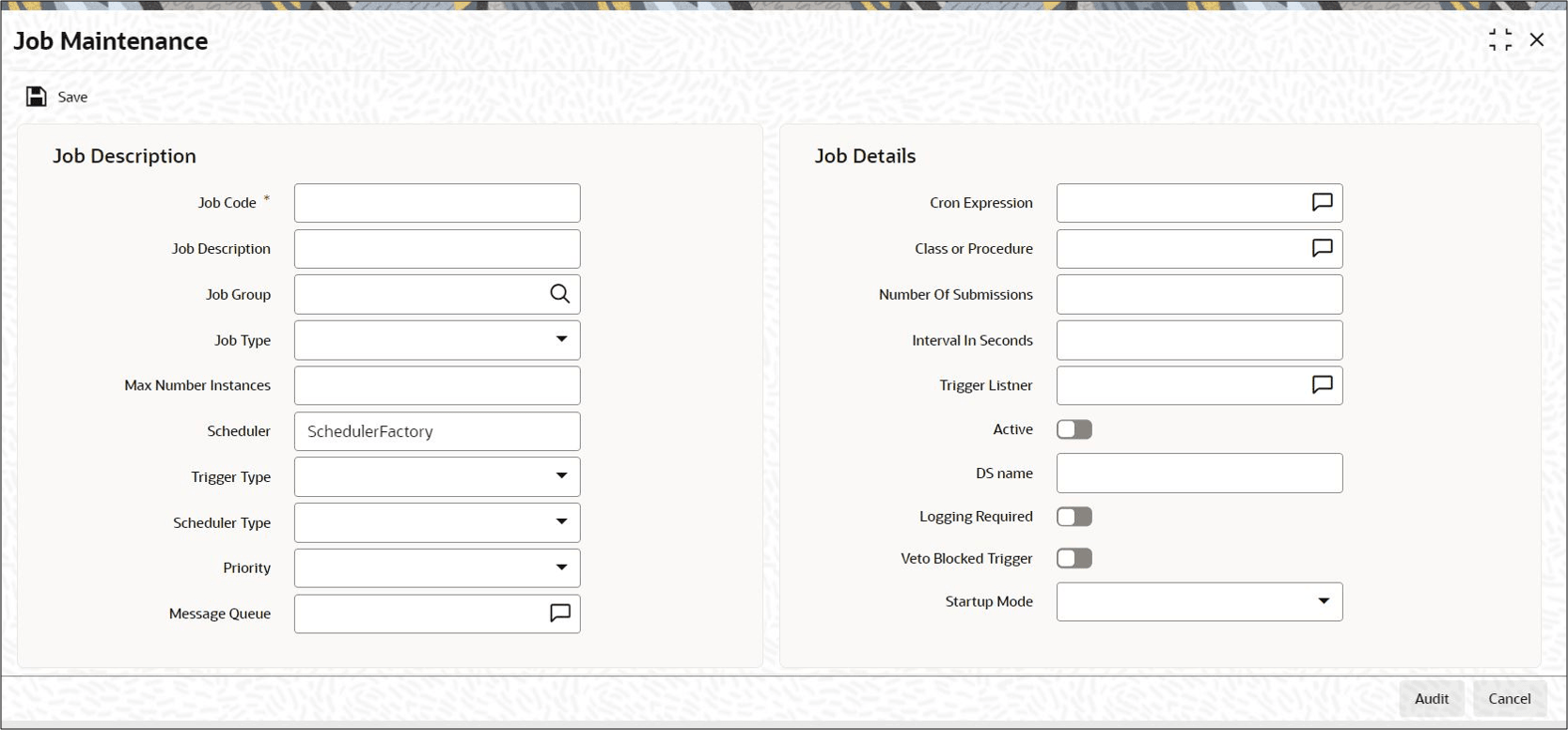

Oracle® FLEXCUBE Investor Servicing enables you to define a job and schedule it using Job Maintenance screen.
  1. On Home screen, type STDJOBMT in the text box, and click Next.
    The Job Maintenance screen is displayed.
  2. On Job Maintenance screen, click New to enter the details.
    Table 1-1 Job Maintenance - Field Description

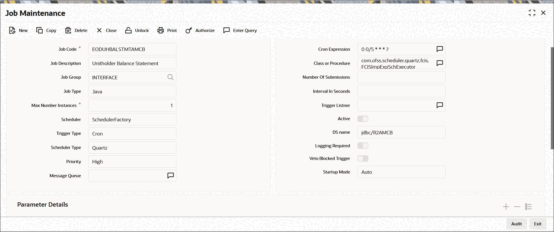

  5. The system will perform the following jobs to execute reports on completion of EOD.
    • Parameter Name: TASKID
    • Parameter Value: Tasks defined
  6. Below job will initiate a TASK – EODUHBALSTMT – Unitholder Balance Statement on completion of EOD.
    The TASK – EODUHBALSTMT is initiated.
    Figure 1-2 TASK – EODUHBALSTMT
    TASK – EODUHBALSTMT
