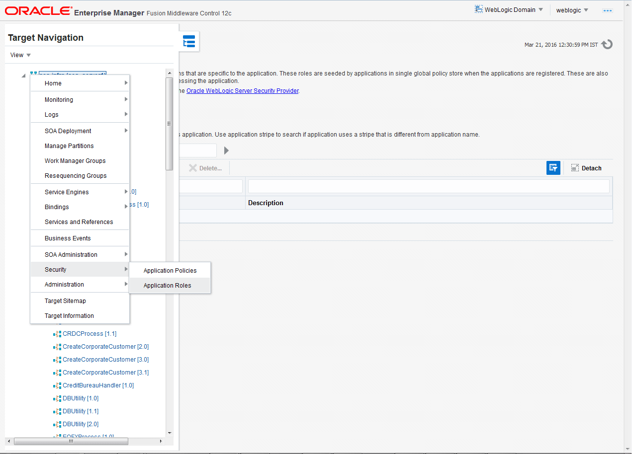

  1. Right click on soa-infra. Select Security and click on Application Roles.
    The Application Roles screen is displayed.
    Figure 1-104 Navigation to the Application Roles

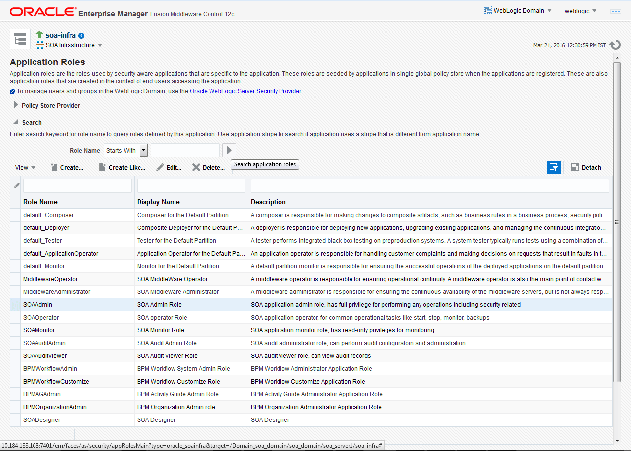

  2. Search the Application Roles name with the Starts With option.
    The soa-infra (Application Roles) screen is displayed.
    Figure 1-105 soa-infra (Application Roles)

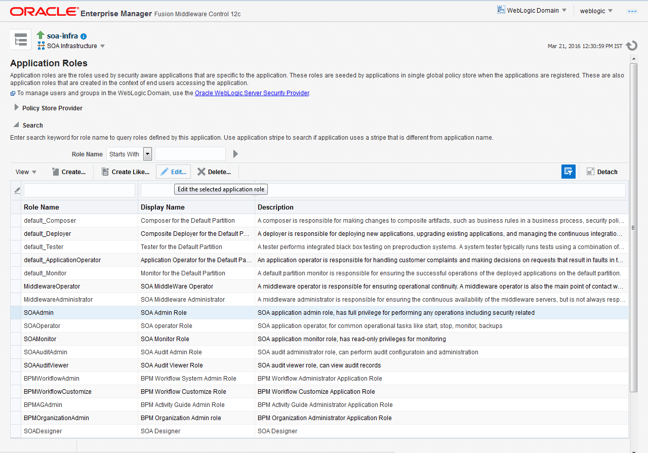

  3. Select the SOAAdmin role and click on Edit option.
    The Edit Application Roles : SOAAdmin screen is displayed.
    Figure 1-106 Edit Application Roles : SOAAdmin

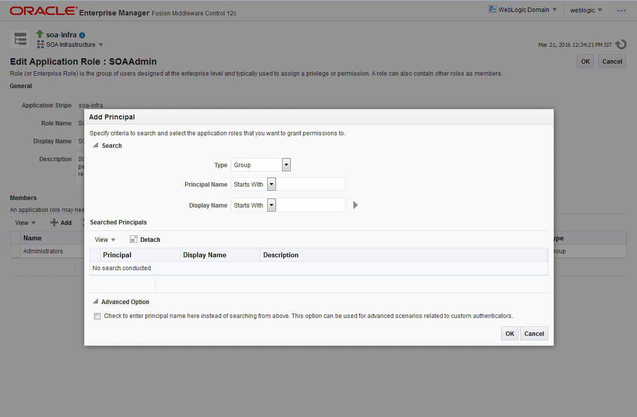

  4. Click on the ADD button and provide the Type as Group from the drop-down.
    The Add Principal pop-up window is displayed.
    Figure 1-107 Application Role - Add Principal

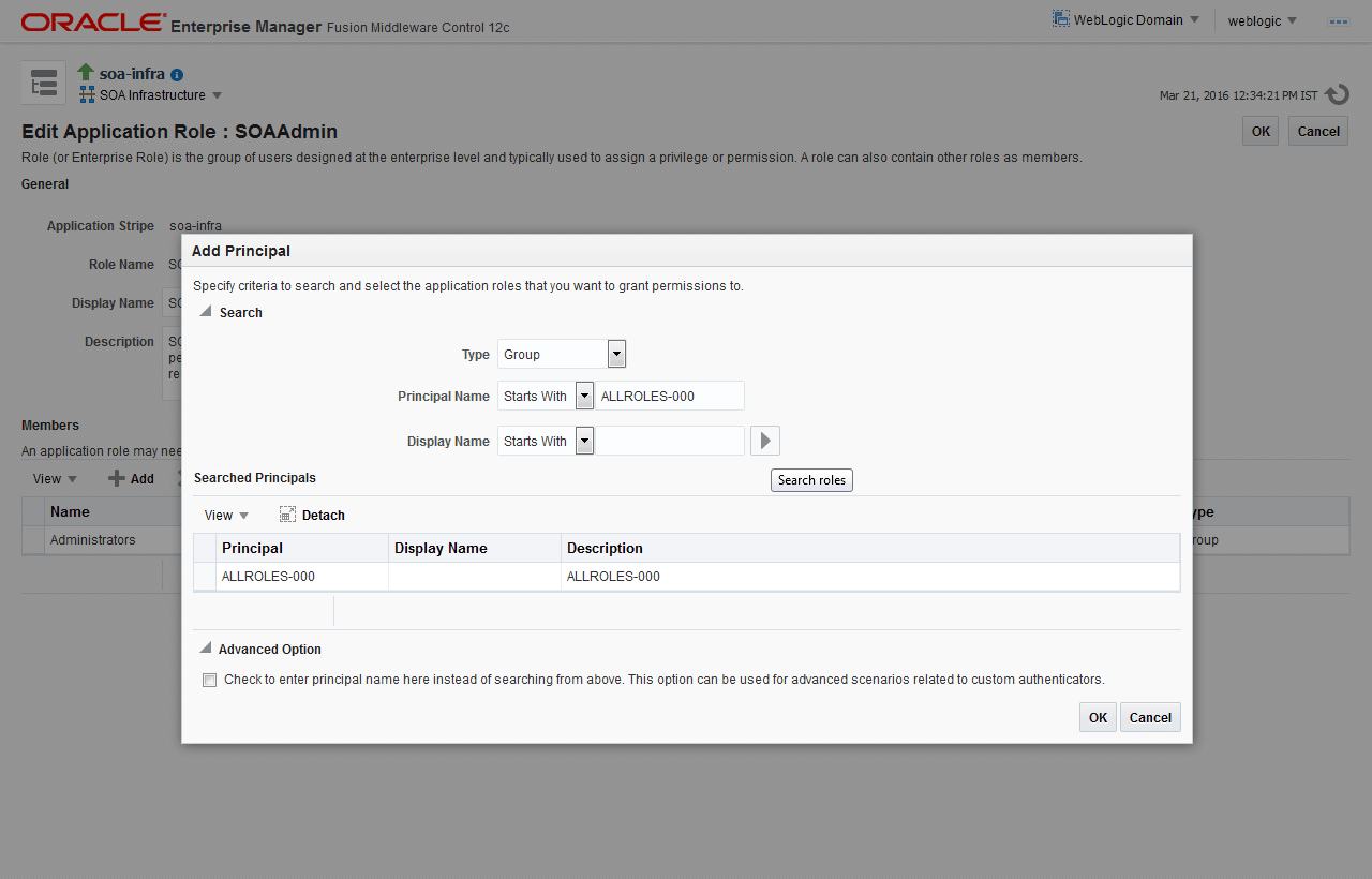

  5. Provide the principal name as (EX: ALLROLES-000) Param_val which is mapped to the OR_ADMINROLE in the cstb_param table and search the role. Click on OK.
    The Add Principal - ALLROLES-000 pop-up window is displayed.
    Figure 1-108 Add Principal - ALLROLES-000
  6. Click the OK button.
