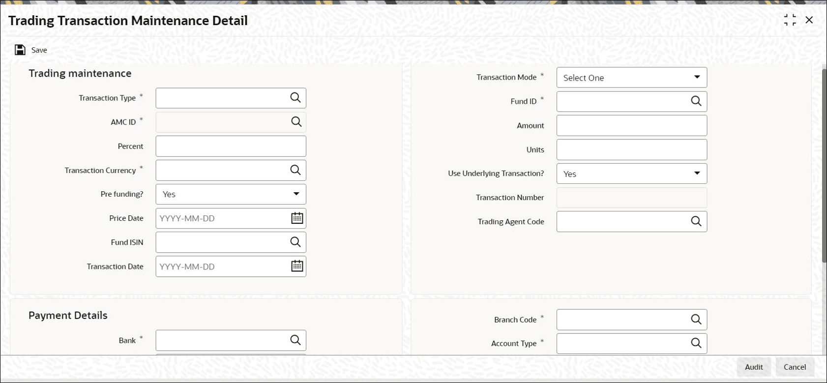

  1. On Home screen, type UTDTRDTX in the text box, and click Next.
    The Trading Transaction Maintenance Detail screen is displayed.
    Figure 1-4 Trading Transaction Maintenance Detail

  2. On Trading Transaction Maintenance Detail screen, click New to enter the details.
    Table 1-5 Trading Transaction Maintenance Detail - Field Description
    Field Description
    Trading Maintenance This section displays the following details.
    Transaction Type
    Alphanumeric; 2 Characters; Mandatory
    Select the type of trading transaction that you are initiating through this screen.
    Transaction Mode
    Mandatory
    Select the mode in which the volume of the transaction must be reckoned and the transaction put through from the drop-down list. The list displays the following values:
    • Amount: The volume of the transaction is specified in terms of an amount. Select this mode for creation and liquidation transactions. It is not allowable for the management transfer transactions.
    • Units: The volume of the transaction is specified in terms of the number of units requested. Select this mode for liquidation transactions and the management transfer transactions. It is not allowable for creation transactions.
    • Percentage: The volume of the transaction is specified as a specific percentage of the holdings already held in the specified fund in the trading box. Select this mode, if applicable, only for liquidation transactions. It is not allowable for any other transaction types.
    When you select the transaction mode in this field, you must specify the actual volume of the transaction in the selected mode in the Amount, Units or Percentage field, as applicable.
    AMC ID
    Alphanumeric; 12 Characters; Mandatory
    Select the ID of the AMC that is initiating the trading transaction from the option list.
    Fund ID
    Alphanumeric; 6 Characters; Mandatory
    Select the ID of the fund in which the AMC is desirous of initiating the trading transaction, from the drop-down list.
    When you specify the ID of the fund, the ISIN Code of the fund is displayed in the ISIN Code field.
    Percent
    Numeric; 5 Characters; Mandatory if the selected Transaction Mode is Percentage
    Indicate the percentage of the holdings of the investor that is to be deemed as the volume of this transaction.
    Units
    Numeric; 27 Characters; Mandatory if the selected Transaction Mode is Units
    Indicate the number of units requested in the transaction.
    Amount
    Numeric; 27 Characters; Mandatory if the selected Transaction Mode is Amount
    Indicate the amount involved in the transaction.
    Transaction Currency
    Alphanumeric; 3 Characters; Mandatory
    Select the currency in which the transactions will be initiated.
    When you select a fund in the Fund Name field, the fund transaction currencies that are allowable for transactions into the selected fund are displayed in the drop-down list in this field, from the Fund Transaction Currency fund rule record that has been maintained for the selected fund.
    Pre funding?
    Optional
    Select Yes or No from the drop-down list to specify whether pre-funding is required or not for UH Mapping. The list displays the following values:
    • Yes
    • No
    Use Underlying Transaction?
    Optional
    Select Yes or No from the drop-down list to specify whether underlying transaction can be used for UH Mapping or not.
    Price Date
    Date format; Mandatory
    Indicate the date on which the desired price that is to be reckoned for allocation of the transaction was prevalent. You can specify a past date, but not a future date. If you specify a past date, it must be a date on which the desired authorized fund price was prevalent.
    Transaction Number
    Display
    The system displays the transaction number.
    FUND ISIN
    Alphanumeric; 12 Characters; Optional
    Select the ISIN Code of the selected fund. If you specify the ISIN Code of a fund, the ID of the fund is displayed in the Fund field.
    Trading Agent Code
    Select the trading agent code from the option list.
    Transaction Date
    Date Format; Mandatory
    Select the date on which the transaction is initiated into the system from the adjoining calendar.
    You can only initiate trading transactions on the application date, and you cannot initiate trading transactions on a future date or a past date.
    Payment Details This section displays the following details.
    Bank
    Specify the bank name of the customer.
    Branch Code
    Specify the branch code of the customer.
    Account Currency
    Specify the account currency code used by the customer.
    Account Type
    Alphanumeric; 1 Character; Mandatory
    Specify the account type.
    Account Number
    Alphanumeric; 34 Characters; Mandatory
    Specify the account number of the customer.
    Account Holder Name
    Alphanumeric; 100 Characters; Mandatory
    Specify the account holder name.
    Payment Mode
    Specify the mode of payment.
    Payment Type
    Optional
    Select the type of payment from the drop-down list. The list displays the following values:
    • Self
    • Third Party
    Clearing Date
    Date Format; Optional
    Select the clearing date from the adjoining calendar.
    Transfer Reference Number
    Alphanumeric; 20 Characters; Optional
    Specify the transfer reference number.
    IBAN
    Alphanumeric; 40 Characters; Optional
    Specify the International Bank Account Number (IBAN) of the account holder.
    By default, the price date is reckoned to be the application date. In such a case, the prevalent price as on the application date need not be available at the time of initiating the trading transaction in this screen, but it must be available when the authorization of the trading transaction is done.
