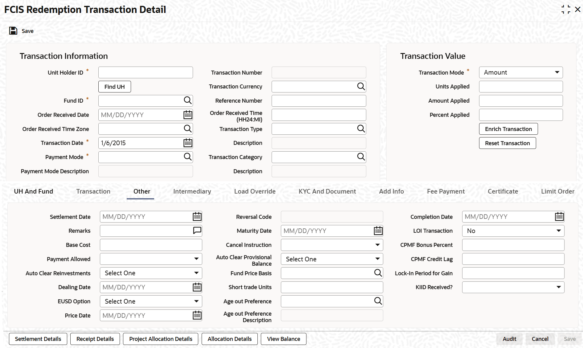

3.12.4 Other Tab
This task topic provides information about other tab details of FCIS Redemption Transaction Detail screen.
- Click on Other tab in the FCIS Redemption Transaction Detail
screen.The Other screen is displayed.
Figure 3-45 FCIS Redemption Transaction Detail - Other
For more information on fields in the screen, refer the below table.
Table 3-63 FCIS Redemption Transaction Detail - Other Tab
Field Description Settlement Date Date Format; Optional Specify the settlement date.
