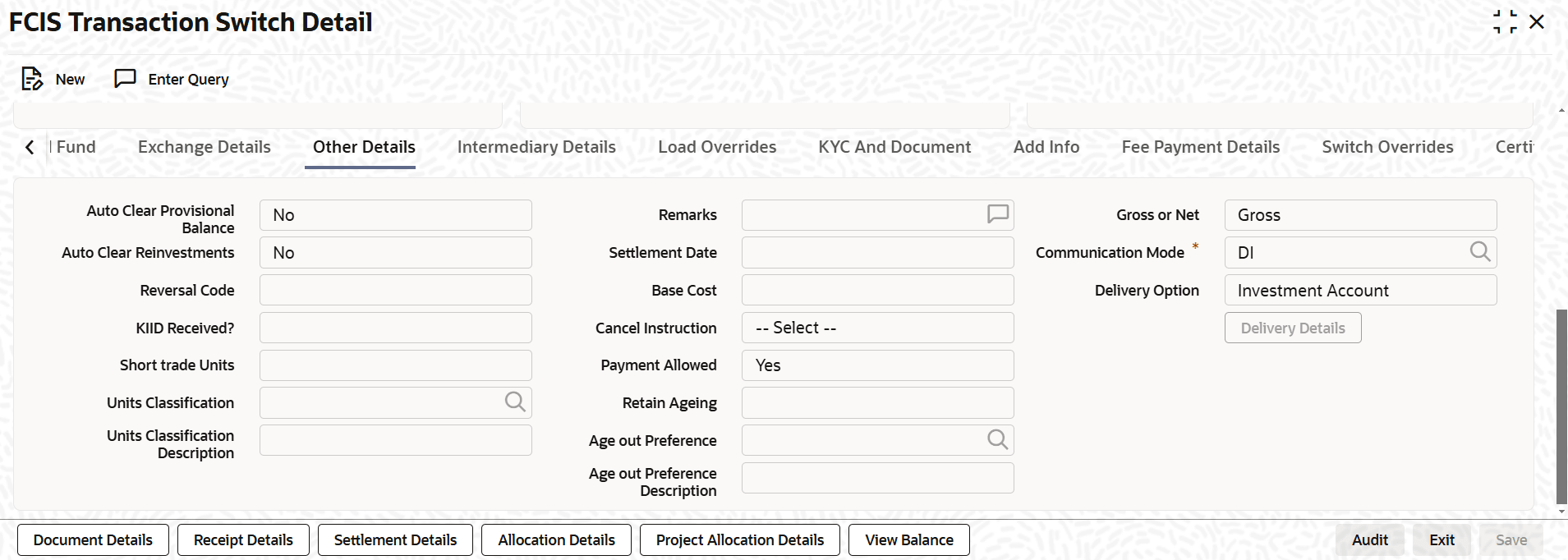

3.16.4 Other Details
This topic explains the Other Details tab in the FCIS Transaction Switch Detail screen.
- Click Other Details tab in the FCIS
Transaction Switch Detail screen.The Other Details are displayed.
Figure 3-67 FCIS Transaction Switch Detail screen - Other Details
- On Other Details tab, specify the fields.For more information on fields, refer to the field description table.
Table 3-90 FCIS Transaction Switch Detail - Other Details Tab
Field Description Auto Clear Provisional Balance Optional Select Yes option from drop-down list to indicate that 100% outflow transaction should include provisionally allotted units.
This option will be enabled if the transaction mode is Percent and the transaction value is 100.
