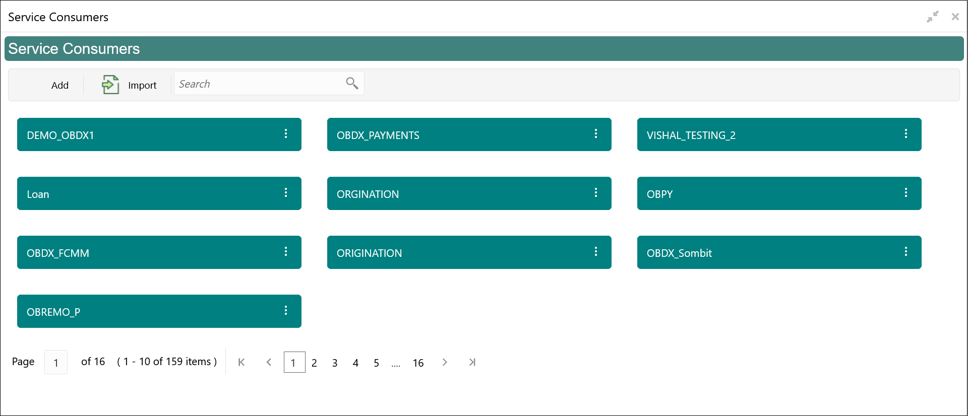

- On Home screen, click Core Maintenance. Under Core Maintenance, click Routing Hub.
- Under Routing Hub, click Service Consumers. The Service Consumers screen displays.

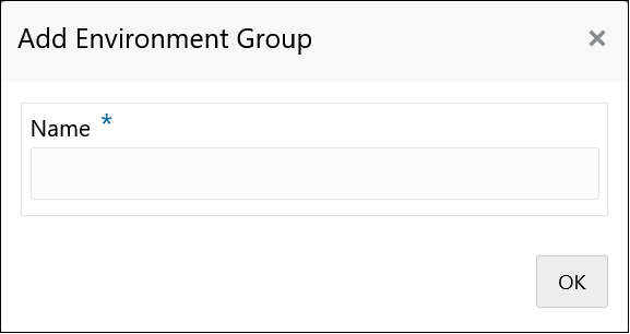

- On Add Service Consumers, click Add and select Group from drop-down list to add the group.The Add Environment Group screen displays.
- Specify the fields on Add Environment Group screen and click OK.
The fields, which are marked with an asterisk, are mandatory.For more information on fields, refer to the field description table.
Table 1-67 Add Environment Group - Field Description
Field Description Name Specify the name of the environment group. Note:
- Enter 0 to maximum of 255 characters.
- No numeric value at beginning and no space allowed.

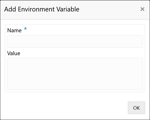

- Click Add on Add Service Consumer screen and select Variable from drop-down list to add the variable.The Add Environment Variable screen displays.
- Specify the fields on Add Environment Variable screen and click OK.
Table 1-68 Add Environment Variable - Field Description
Field Description Name Specify the name of the environment variable. Note:
Value Specify the value of the environment variable. The value can either be hardcoded or Velocity mapping.

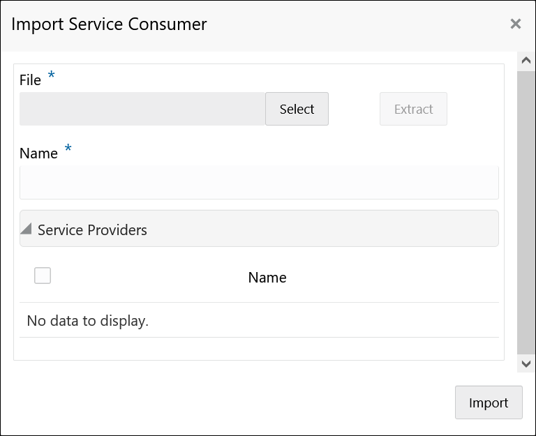

Import Service Consumer
- Click Import.The Import Service Consumer screen displays.
- Specify the fields on Import Service Consumer screen and click OK.
Table 1-69 Import Service Consumer - Field Description
Field Description File Select the file using Select. Note:
Allows only to select one file and accepts only JSON file.Extract Extracts the consumer name and service provider list from JSON file and displays it in the respective elements. Name Specify the name of the service provider. Note:
Name Displays the list of service providers names that are present in JSON file. - Click Import to import the selected file.The Confirmation screen displays.
Figure 1-72 Confirmation - Import Service Consumer
- Click Confirm to import the service consumer.
Below data needs to be changed after importing provider configuration file:- Implementation Host and Port
- Implementation Authentication Password

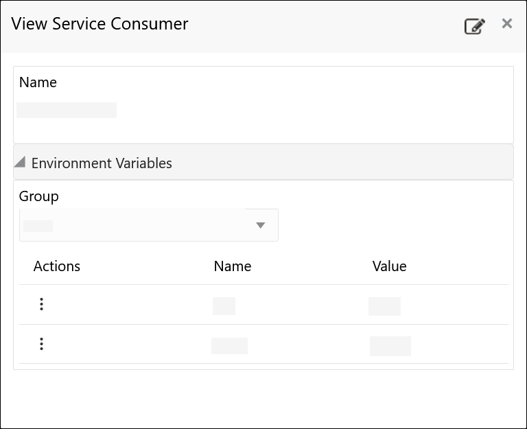

View Service Consumer
- Click 3 dots button (operation menu) and click View.The View Service Consumer screen displays.
The user can click edit button to edit the Service Consumer.

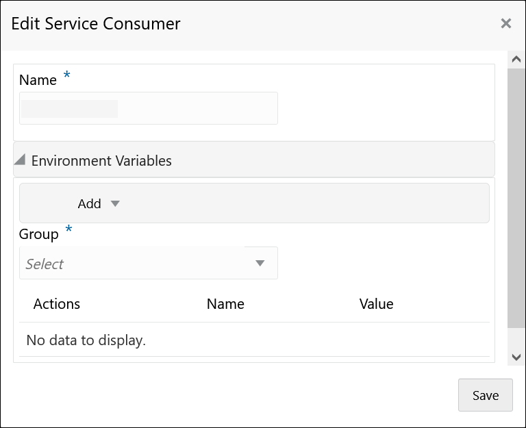

Edit Service Consumer
- Click 3 dots button (operation menu) and click Edit.The Edit Service Consumer screen displays.
- Click Save once the edit is done.The Confirmation screen displays.
Figure 1-75 Confirmation - Edit Service Consumer
- Click Confirm to save the record.

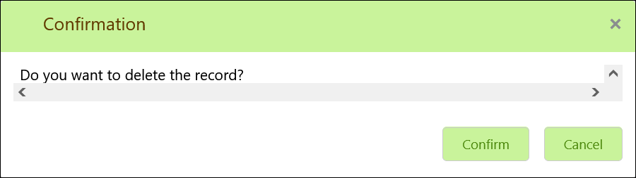

Delete Service Consumer
- Click 3 dots button (operation menu) and click Delete.The Confirmation screen displays.
Figure 1-76 Confirmation - Delete Service Consumer
- Click Confirm to delete the record.

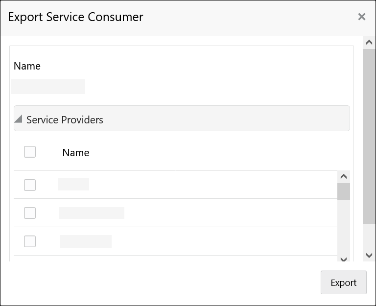

Export Service Consumer in JSON
- Click 3 dots button (operation menu) and click Export. Select JSON.The Export Service Consumer screen displays.
Figure 1-77 Export Service Consumer - JSON
- The user has an option to select service providers from the list which needs to be exported or can click on select all for all service providers.
- The JSON Export feature exports below data:
- Selected service consumer
- All consumer services
- Selected service providers with services
- Default implementation of selected service providers with services (without Host, Port and Authentication Password)
- Default transformations
- All default implementation routes
- Select the required service providers and click Export.The Confirmation screen appears.
Figure 1-78 Confirmation - Export Service Consumer in JSON
- Click Confirm to export in JSON.
