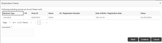

For example, if there is a customer by name “Vinay” and user will try to create a customer with the same name again. Then the system will display duplicate record as below. - Dedupe check will fetch the matches found against the
- Information of existing customers present in the system
- Information of the customers for whom the onboarding application was denied/rejected
- By default, the system validates based on customer first name. If other attributes required for dedupe check that can be configured.
