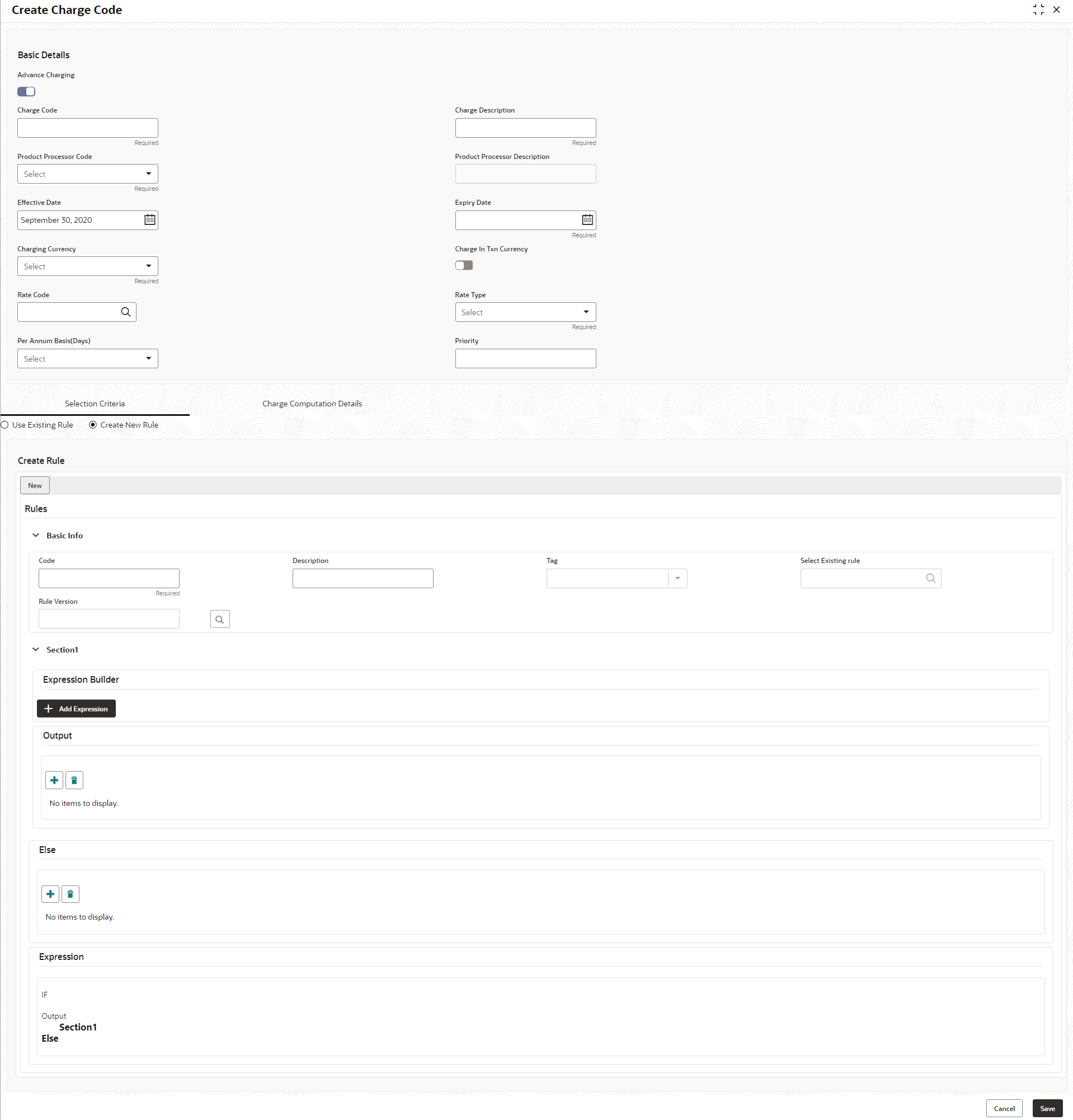

  4. On Create Charge Code screen, click Selection Criteria tab to define selection criteria rules.
    The Create Charge Code - Selection Criteria screen displays.
    This tab is visible only if the Advance Pricing toggle is enabled.
    Figure 3-88 Create Charge Code - Selection Criteria
    Table 3-93 Create Charge Code - Selection Criteria - Field Description
    Field Description
    Use Existing Rule By default, this option is enabled. Indicates if the existing rule is linked.
    Rule Code Select the rule code from the drop-down list.
    Rule Icon
    Click this icon to get the information about the rule.
    Rule Name Displays the rule name of the rule code.
    Create New Rule Select this option to create new rule.
    Code Specify the rule code.
    Description Specify the rule description.
    + icon Click this icon to add new expression.
    Fact / Rules Select the fact or rule from the drop-down list.
    Once the user selects the fact/rules, one more field opens adjacent to the output, update the same based on the selected output option.
    Operator Select the comparison operator from the drop-down list.
    The available options are:
    • Contains
    • In
    • Matches
    • NotMatches
    • NotContains
    • Notin
    Data Type Select the data type for the fact or rule.
    Once the user select the data type, one more field opens adjacent to the output, update the same based on the selected output option.
    • Text
    • Number
    • Boolean
    • Date
    • Fact
    • Rules
    The below option appears if the Data Type is selected as Boolean.
    • True
    • False
    Output Select the output from the drop-down list.
    • Text
    • Number
    • Boolean
    • Date
    • Fact
    • Rules
    • True
    • False
    Expression Displays the expression updated in the expression builder.

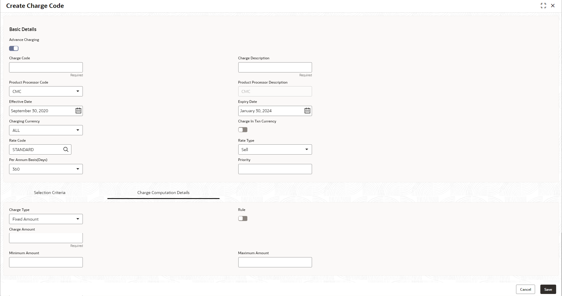

  5. On Create Charge Code screen, click Charge Computation Details to define computation details.
    The Create Charge Code - Charge Computation Details screen displays.
    Figure 3-89 Create Charge Code - Charge Computation Details
    Table 3-94 Create Charge Code - Charge Computation Details - Field Description
    Field Description
    Charge Type Select the type from the drop-down list. The available options are:
    • Fixed Amount
    • Fixed Percentage
    • Tiered
    Charge Amount Specify the amount for the charge type.
    This field is visible if the Charge Type is selected as Fixed Amount.
    Percentage (%) Specify the percentage for the charge type.
    This field is visible if the Charge Type is selected as Fixed Percentage.
    Minimum Amount Specify the minimum amount to be charged.
    This field will not be visible if the Charge Type is selected as Fixed Amount.
    Maximum Amount Specify the maximum amount to be charged.
    Tiered Charge Type Select the tiered charge type from the drop-down list. The available options are:
    • Amount
    • Percentage
    • Amount or Percentage
    This field is visible if the Charge Type is selected as Tiered.
    The below option appears if the Advance Charging is enabled.
    • Rule
    • Amount or Rule
    • Percentage or Rule
    Tier Type Select from tier type the drop-down list. The available options are:
    • Cumulative
    • Slab
    Charge Per Count Click on toggle status to enable the parameter.
    This field is visible if the Charge Type is selected as Tiered and Tier Charge Type as Amount, Amount or Rule, and Rule.
    Tier Criteria Select the tier criteria from the drop-down list. The available options are:
    • Amount
    • Period
    • Amount or Period
    The system will not allow use to select the above options if the Tier Type is selected as Slab.
    + icon Click to add a new row.
    - icon Click to delete the row.
    Amount / Period / Amount or Period - From Specify the start value of the count range.
    This field is visible only if the Charge Typeis selected as Tiered.
    Amount / Period / Amount or Period - To Specify the final value of the count range
    This field is visible only if the Charge Type is selected as Tiered.
    Amount Specify the amount.
    This field is visible only if the Charge Type is selected as Tiered and Tiered Charge Type as Amount.
    Percentage Specify the charge percentage.
    This field is visible only if the Charge Type is selected as Tiered and Tiered Charge Type as Percentage.
    Output Option Select the option from which the output must be displayed.
    This field is visible only if the Charge Type is selected as Tiered and Tiered Charge Type as Amount or Percentage.
    Output Specify the output.
    Basis of Select from the drop-down list.
    This field is visible only if Charge Type is selected as Tiered and Advance Charging is enabled.
    Rule Toggle to enable if the rule is applicable.
    This field is visible only if the Advance Charging and Rule is enabled and Charge Type is selected as Fixed Amount or Fixed Percentage.
    Rule ID Select the rule from the drop-down list.
    This filed is visible if the Advance Charging and Rule is enabled.

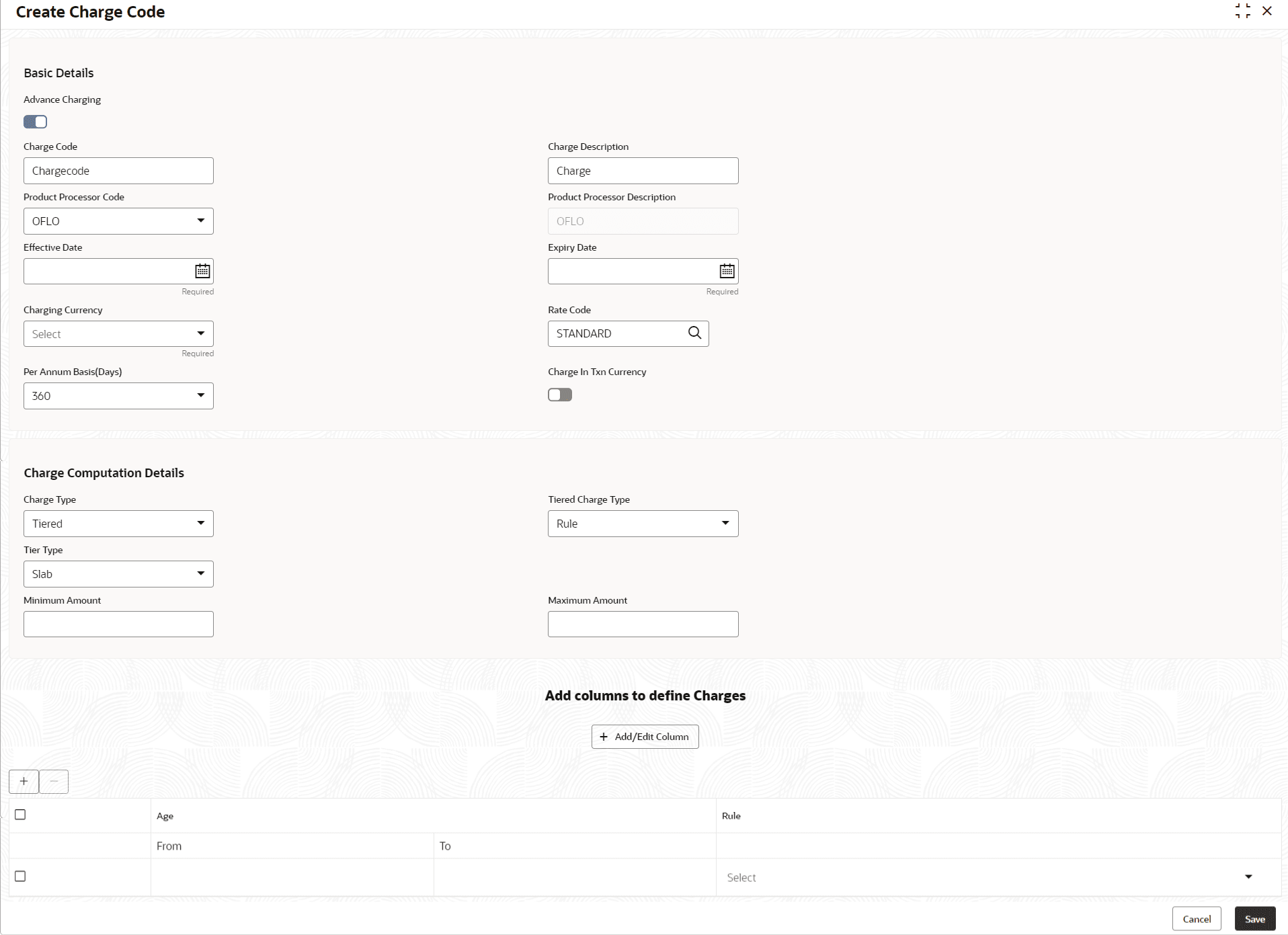

  6. Select the Charge Type as Tiered to link the features.

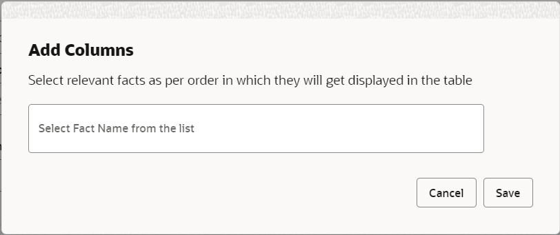

  7. Click + Add/Edit column to select and link the facts.
    The + Add/Edit column pop-up screen displays.
  8. Select the facts names from the list. ( 'n' number of facts can be selected)
  9. Click Save to link the features for defining the tiered charge type.
    The Create Charge Code - Charge Computation Details (Tiered) screen displays.
    Figure 3-91 Create Charge Code - Charge Computation Details (Tiered)
    Table 3-95 Create Charge Code - Charge Computation Details (Tiered)
    Field Description
    + icon Click this icon to add a new row.
    - icon Click this icon to delete a row, which is already added.
    <Numeric Feature>From Specify the minimum numeric value of the facts selected.
    <Numeric Feature>To Specify the maximum numeric value of the facts selected.
    <Numeric Feature>Value Specify the value of the facts selected.
    Rule Select the rule from the drop-down list.
    Rule Icon
  10. Click Save to save the details.
