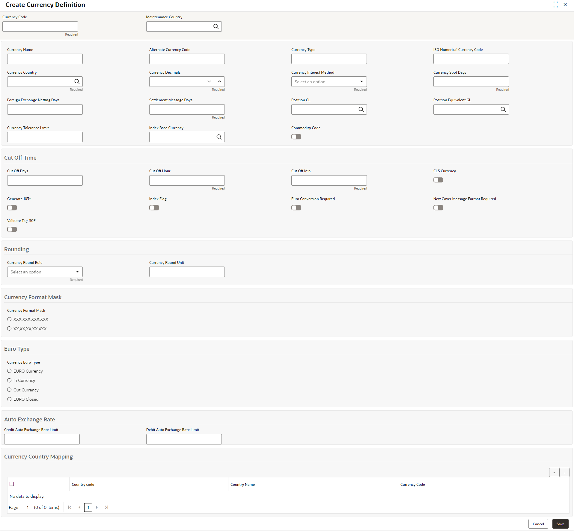

1.10.1 Create Currency Definition
This topic describes the systematic instructions to define currency.
Specify User ID and Password, and login to Home screen.
  1. On Home screen, click Core Maintenance. Under Core Maintenance, click Currency Definition.
  2. Under Currency Definition, click Create Currency Definition.
    The Create Currency Definition screen displays.
    Figure 1-23 Create Currency Definition
  3. Specify the fields on Create Currency Definition screen.
    The fields marked as Required are mandatory.
