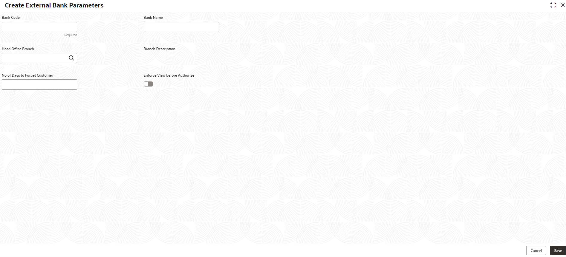

    The Create External Bank Parameters screen displays.
    Figure 1-41 Create External Bank Parameters
  3. Specify the fields on Create External Bank Parameters screen.
    The fields marked as Required are mandatory.
    Table 1-41 Create External Bank Parameters – Field Description
    Field Description
    Bank Code Specify the three-digit bank code that uniquely identifies a specific bank within the system.
    Bank Name Specify the full name of the bank associated with the code provided.
    Head Office Branch Click Search icon to view and select the required head office branch.
    This will represent a three-digit code indicating the primary location linked with the bank code.
    Branch Description Displays the branch description based on the selected Head Office Branch.
    Number of Days to Forget Customer Specify the number of days to inactive/forget the customer.
    This field determines the duration for which a customer's record will persist in the system after they close all their accounts with the bank. Once the specified number of days has elapsed, the customer's record will be deleted from the system.
    Enforce View before Authorize Click the toggle to enable this feature.
    If this button is toggled, dual authorization will be enabled. An authorized user must review all modifications made to any common core parameter before they are approved within the system
  4. Click Save to save the details.
