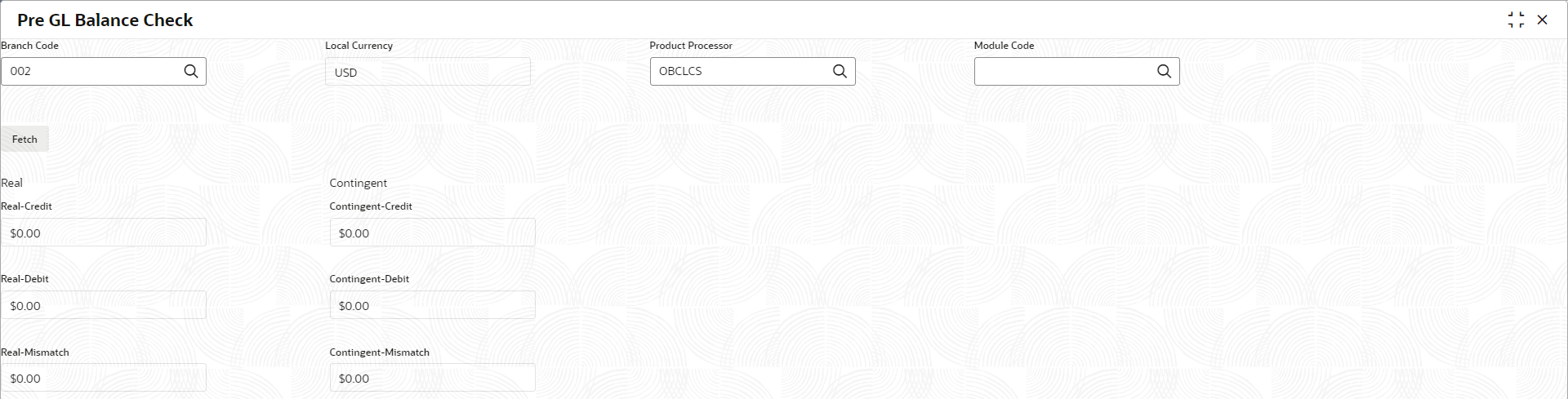

    The Pre GL Balance Check screen displays.
    Figure 1-51 Pre GL Balance Check
  3. Specify the fields on Pre GL Balance Check screen.
    The fields marked as Required are mandatory.
    Table 1-51 Pre GL Balance Check – Field Description
    Field Description
    Branch Code Click the Search icon and select the branch code from the list to view the GL balance.
    Filter based on Branch Code.
    Local Currency Auto populates the local currency based on the branch code selected.
    Filter based on Local Currency.
    Product Processor Click the Search icon and select the product processor to which the GL balance to view.
    Filter based on Product Processor.
    Module Code Click the Search icon and select the module code to which the GL balance to view.
    Filter based on Module Code.
  4. Click the Fetch button to view the real and contingent balance.
