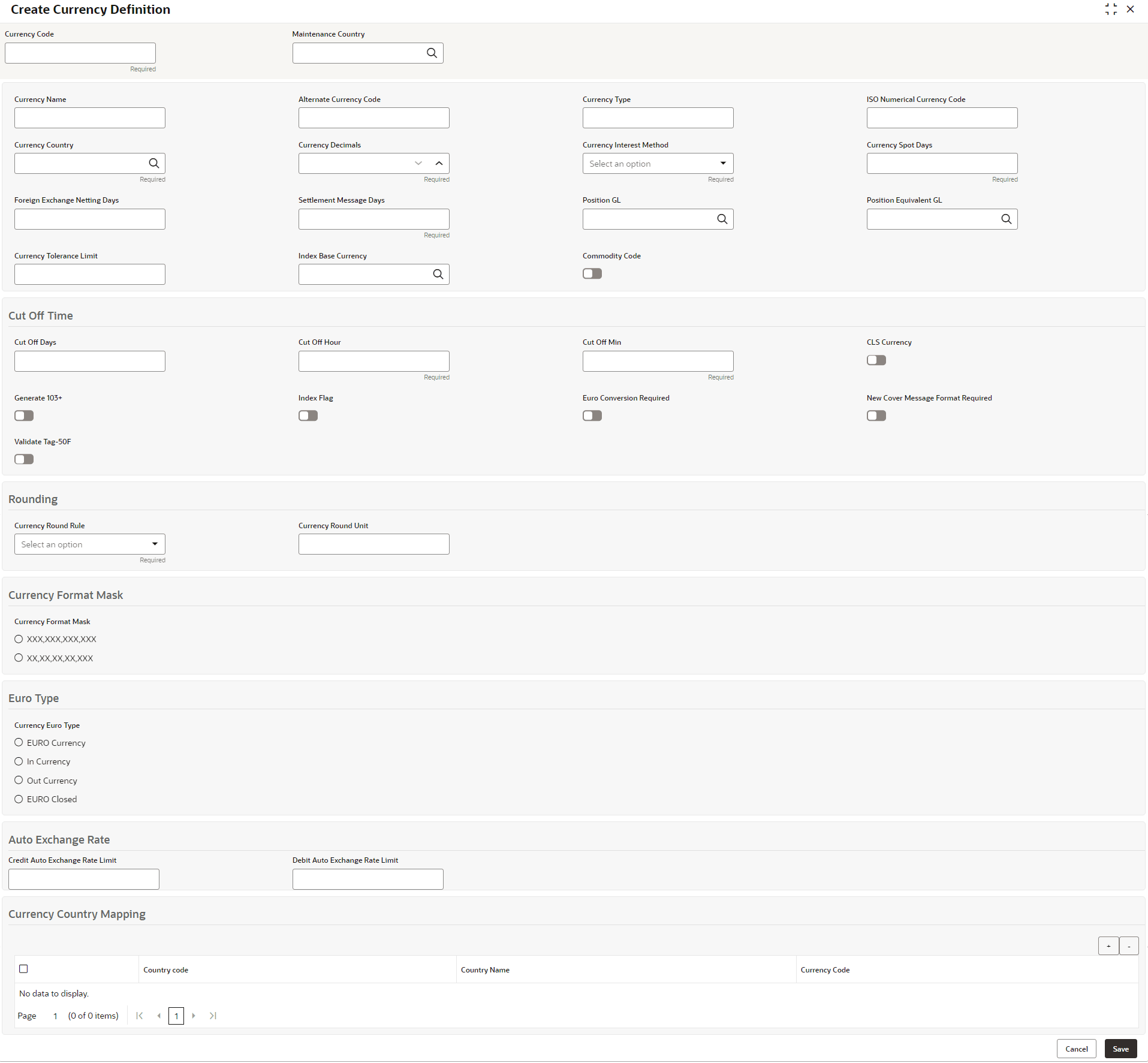

1.10.1 Create Currency Definition
This topic describes the systematic instructions to define currency.
- On Home screen, click Core Maintenance. Under Core Maintenance, click Currency Definition.
- Under Currency Definition, click Create Currency Definition.The Create Currency Definition screen displays.
- Specify the fields on Create Currency Definition screen. For more information on fields, refer to the field description table.
The fields marked as Required are mandatory.Table 1-23 Create Currency Definition – Field Description

- Click Save to save the details.The Currency definition is successfully created and can be viewed using the View Currency Definition screen.
- Click Cancel to discard the changes and close the screen.
