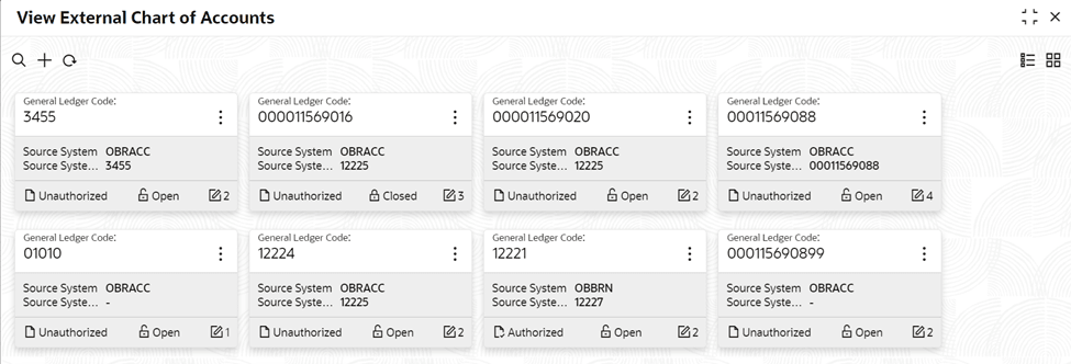

    The View External Chart of Accounts screen is displayed.
    Figure 1-43 View External Chart of Accounts
    Table 1-43 View External Chart of Accounts – Field Description
    Field Description
    General Ledger Code This field denotes the GL Code. This is GL accounts used to transfer the funds between accounts. This account is mapped with multiple debit/ credit transactions
    Source System This field denotes the system to which GL Code belongs. For example - FCUBS etc.
    Source System GL Code This field denotes the GL code of the source system.
    Authorization Status This field denotes authorization status of the GL Code.
    The options are:
    • Authorized
    • Rejected
    • Unauthorized
    Record Status This field denotes the record status of the GL Code.
    The options are:
    • Open
    • Closed
    Modification Number Displays the number of modification performed on the record.
