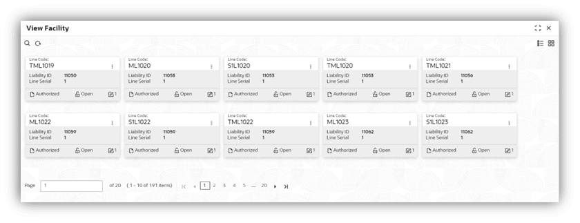

1.48.2 View Facility Summary
This topic describes the systematic instructions to view the list of authorized facilities from the ELCM system.
  1. From Home screen, click Core Maintenance, under Core Maintenance, click Limits and Collaterals.
  2. Under Facility, click View Facility.
    The View Facility summary screen is displayed. For more information on fields, refer to the field description table.
