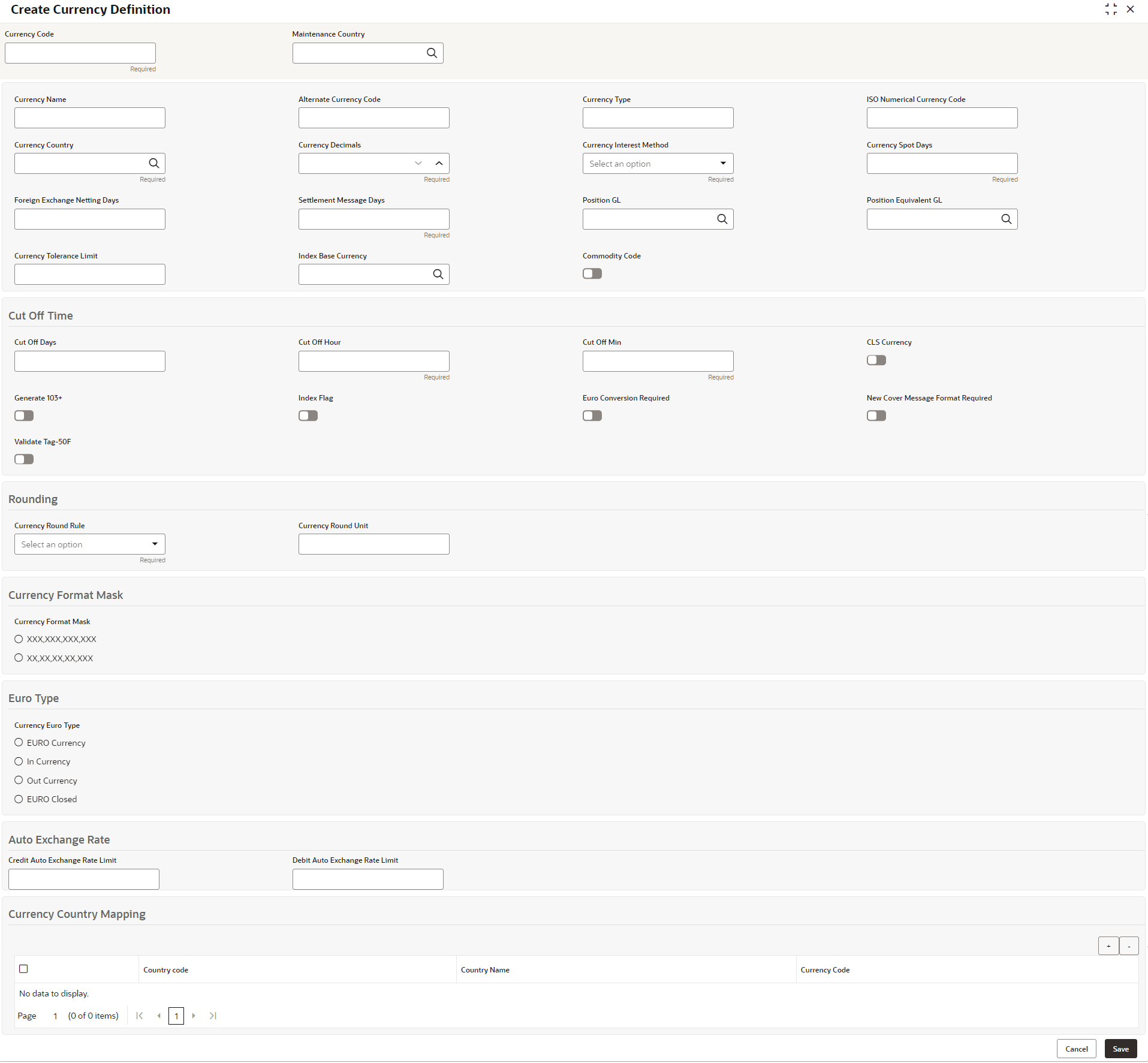

1.11.1 Create Currency Definition
This topic describes the systematic instructions to define currency.
  1. From Home screen, click Core Maintenance. Under Core Maintenance, click Currency Definition.
  2. Under Currency Definition, click Create Currency Definition.
    The Create Currency Definition screen is displayed.
    Figure 1-26 Create Currency Definition
  3. Specify the fields on the Create Currency Definition screen.
    The fields marked as Required are mandatory.

  4. Perform one of the following action:
    • Click Save to save the details.
      The Currency definition is successfully created and can be viewed using the View Currency Definition screen.
    • Click Cancel to discard the changes and close the screen.
