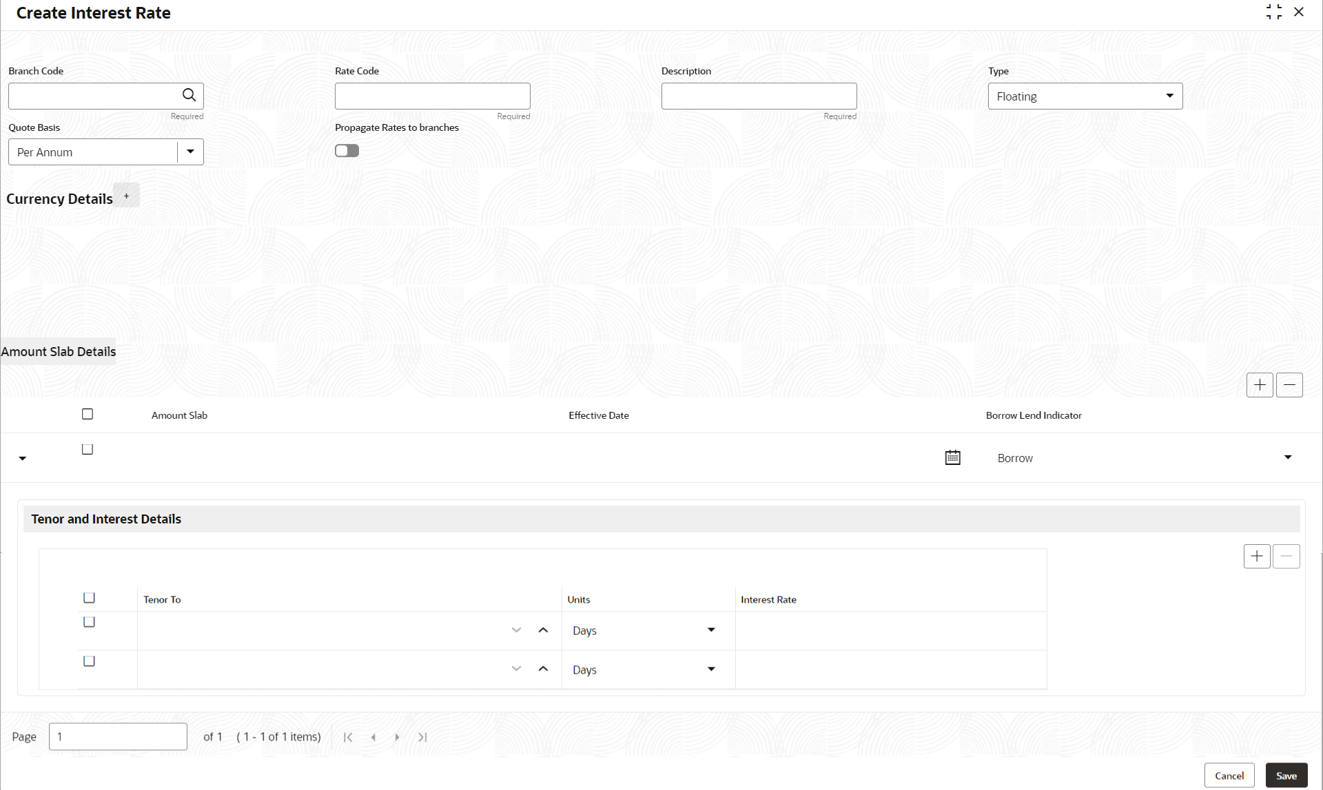

  1. From Home screen, click Core Maintenance. Under Core Maintenance, click Interest Rate Maintenance.
  2. Under Interest Rate Maintenance, click Create Interest Rate.
    The Create Interest Rate screen is displayed.
    Figure 1-63 Create Interest Rate
  3. Specify the fields on the Create Interest Rate screen.
    The fields marked as Required are mandatory.
    Table 1-63 Create Interest Rate – Field Description
    Field Description
    Branch Code Click the Search icon to view and select the branch from the list. The list displays all the branch code maintained in the system.
    Rate Code Specify the rate code for the selected branch.
    Description Specify the description of the rate code.
    Type Select the rate type from the drop-down list.
    The available options are :
    • Fixed
    • Floating
    Quote Basis Select the quote basis for the rate from the drop-down list.
    • Per Annum
    • Exponential-252
    • Exponential-365
    • Linear-360
    Propagate Rates to branches Click the toggle status to enable the propagate rates across all the branches of the bank.
    Note: When the rate code is modified at the Head Office Branch a corresponding rate code record will be created and replicated to all the branches.
    Currency Details Click + icon and popup screen appears to add the associates currencies to the rate code.
    Currency Code Click the Search icon to view and select the currency from the list.
    Description Displays the description of the selected currency code.
  4. Perform the following actions for Amount Slab Details:
    1. Click + button to add the new row to amount slab.
      Table 1-64 Amount Slab Details - Field Description
      Field Name Description
      Amount Slab Specify the amount for the rate code.
      Effective Date Select the date from when the rate needs to be effective for the amount slab.
      Note: The effective date will be applicable until the new effective date Is provided for the rate.
      Borrow Lend Indicator Select the borrow lend indicator of the rate from the drop-down list.
      The available options are:
      • Borrow - The rate is applied for deposits taken by the bank
      • Lend- The rate is applied for loans given to Customers.
    2. Select the rows and click - button to delete the rows added for amount slab.
  5. Perform the following actions for Tenor and Interest Details:
    1. Click + button to add the new row to tenor and interest details.
      Table 1-65 Tenor and Interest Details - Field Description
      Tenor To Specify the tenor upto which the interest rate needs to be effective.
      Units Select the units for the tenor slab from the drop-down list.
      • Days
      • Weeks
      • Months
      • Years
      Interest Rate Specify the interest rate of the rate code for the tenor.
    2. Select the rows and click - button to delete the rows added for tenor and interest details.
  6. Perform one of the following action:
    • Click Save to save the details.
      The Interest Rate Maintenance is successfully created and can be viewed using the View Interest Rate screen.
    • Click Cancel to discard the changes and close the screen.
