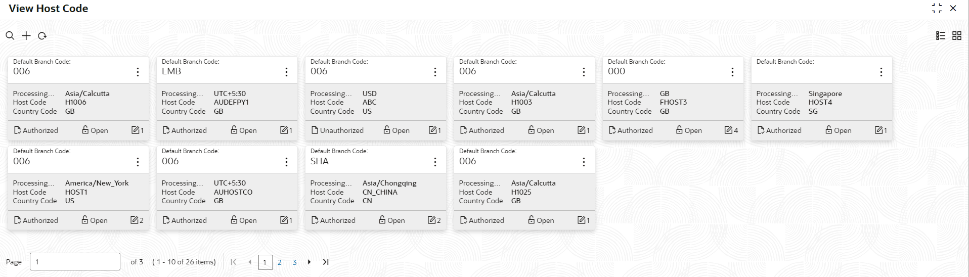

1.29.2 View Host Code
This topic describes the systematic instructions to view the list of configured host codes.
The user can configure host code using Create Host Code screen.
  1. From Home screen, click Core Maintenance. Under Core Maintenance, click Host Code.
  2. Under Host Code, click View Host Code.
    The View Host Code screen is displayed.
    Table 1-62 View Host Code – Field Description
    Field Description
    Default Branch Code Displays the default branch code associated with the host code.
    Processing Time Zone Displays the processing time zone.
    Host Code Displays the host code details.
    Country Code Displays the country code details.
    Authorization Status Displays the authorization status of the record.
    The options are:
    • Authorized
    • Rejected
    • Unauthorized
    Record Status Displays the status of the record.
    The options are:
    • Open
    • Closed
    Modification Number Displays the number of modification performed on the record.
