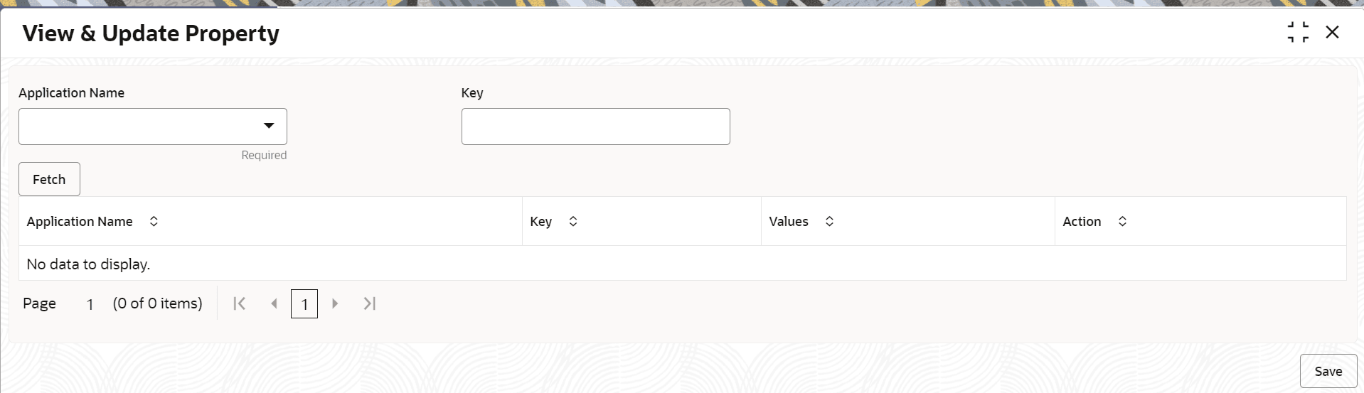

  1. On Home screen, click Party Services. Under Party Services, click Maintenance.
  2. Under Maintenance, click Properties Maintenance. Under Properties Maintenance, click View & Update Property.
    The View & Update Property screen is displayed.
    Figure 1-25 View and Update Property
  3. On the View and Update Property screen, specify the details. For more information on fields, refer to the field description table.
    Table 1-17 View and Update Property - Field Description
    Field Description
    Application Name Select the application name from the drop-down list.
    Key Specify the key.
    Application Name Displays the selected application name.
    Key Displays the key of the application.
    Values Displays the value of the application.
    Action Click the necessary icon to edit or save a row.
  4. Click Save.
