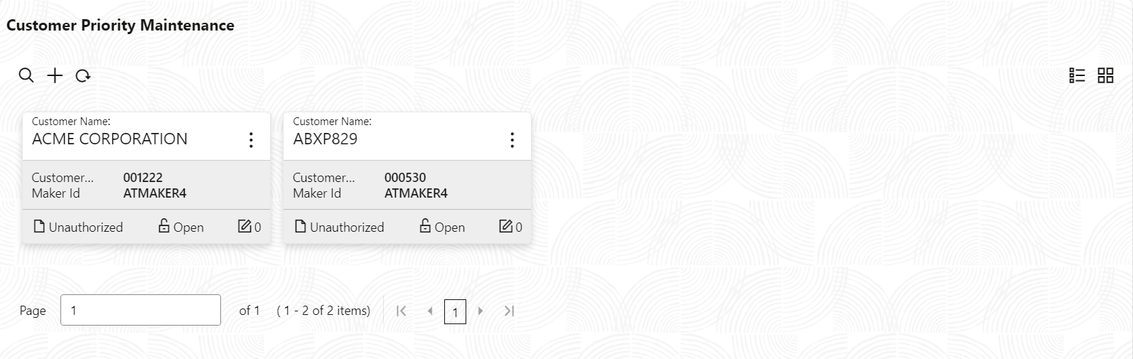

This topic describes the systematic instructions to view the list of configured Customer Priority Maintenance.
- On Home screen, click Core Maintenance. Under Core Maintenance, click Priority Code.
- Under Priority Code, click Customer Priority
Maintenance.The Customer Priority Maintenance screen displays.
Table 1-84 Customer Priority Maintenance – Field Description
Field Description Customer Name Displays the name of the customer priority configured. Customer Code Displays the code of the customer priority. Authorization Status Displays the authorization status of the record. The options are:- Authorized

Record Status Displays the status of the record. The options are:- Open
- Closed
Modification Number Displays the number of modification performed on the record. - Click
button to configure the new customer priority maintenance.The Customer Priority Maintenance screen displays. - Specify the fields on Customer Priority Maintenance
screen.For more information on fields, refer to the field description table.
The fields marked as Required are mandatory.Table 1-85 Customer Priority Maintenance – Field Description
