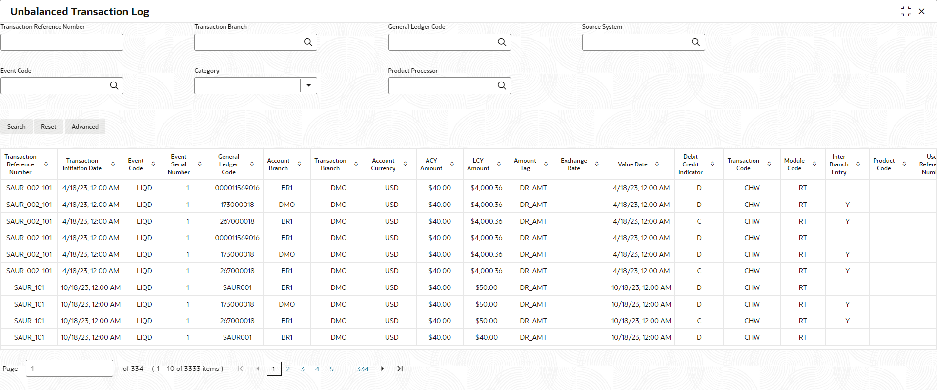

    The Unbalanced Transaction Log screen displays.
    Figure 1-46 Unbalanced Transaction Log
  3. Specify the fields on Unbalanced Transaction Log screen.
    Table 1-46 Unbalanced Transaction Log – Field Description

  4. Click the Search button to view the unbalanced details.
  5. Click the Reset button to clear the search criteria.
