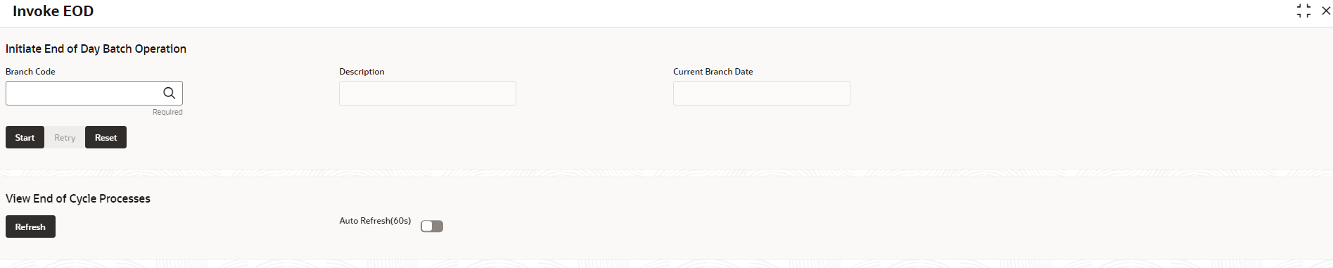

    The Invoke EOD screen displays.
  3. specify the fields on Invoke EOD screen.
    The fields marked as Required are mandatory.
    Table 1-13 Invoke EOD – Field Description
    Field Description
    Branch Code Specify the branch code that is associated with the logged in user.
    Description Displays the description of the branch, based on the Branch code selected.
    Current Branch Date Displays the current branch date, based on the Branch code selected.
  4. Click Start to invoke EOD for selected branch and click Refresh to view the current status of batch.
  5. Click Retry to restart the EOD work-flow from the failed task.
    The Retry button enables only if the failed task status is encountered.
  6. Click Reset to clear the branch selected.
  7. Click Refresh to view the current status of batch.
  8. Mouse-hover on the task to view the relevant details such as Start time, End time, and Error if any.
