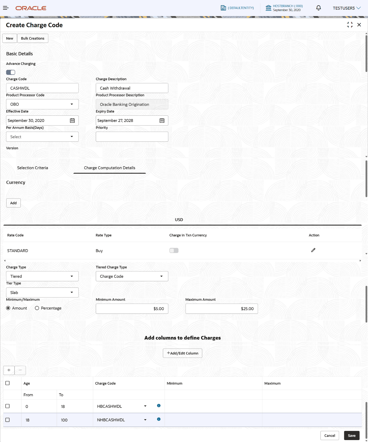

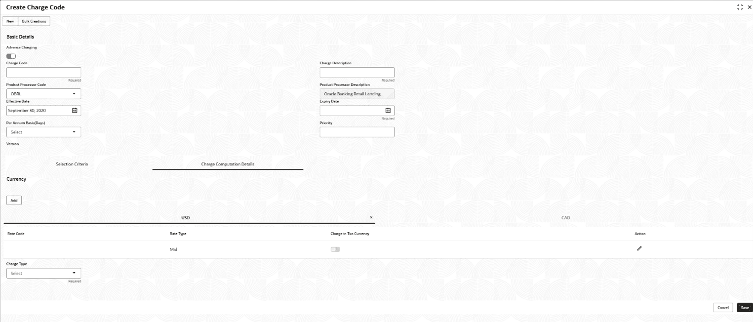

  5. On the Create Charge Code screen, click Charge Computation Details to define computation details.
  6. Click Add under currency,
    The Add Currency panel drawer will open to capture currency details.
  7. After selecting currency details, when user clicks on Add, the Create Charge Code - Charge Computation Details screen is displayed.
    More than one currencies can be added now and each of them can have a different charge calculation logic.
    The Create Charge Code - Charge Computation Details screen is displayed.
    Figure 3-89 Create Charge Code - Charge Computation Details
    Figure 3-90 Create Charge Code - Charge Computation Details

  8. Select the Charge Type as Tiered to link the features.
  9. Click + Add/Edit column to select and link the facts.
    The + Add/Edit column pop-up screen is displayed.
  10. Select the facts names from the list. ( 'n' number of facts can be selected)
  11. Click Save to link the features for defining the tiered charge type.
    The Create Charge Code - Charge Computation Details (Tiered) screen is displayed.
    Figure 3-92 Create Charge Code - Charge Computation Details (Tiered)

    Figure 3-93 Create Charge Code - Charge Computation Details (charge code as output)- Cumulative
    Figure 3-94 Create Charge Code - Charge Computation Details (charge code as output)-Slab
    In both the above examples, the output of the child charge code will be used for the computation in cumulative/ slab calculation.
