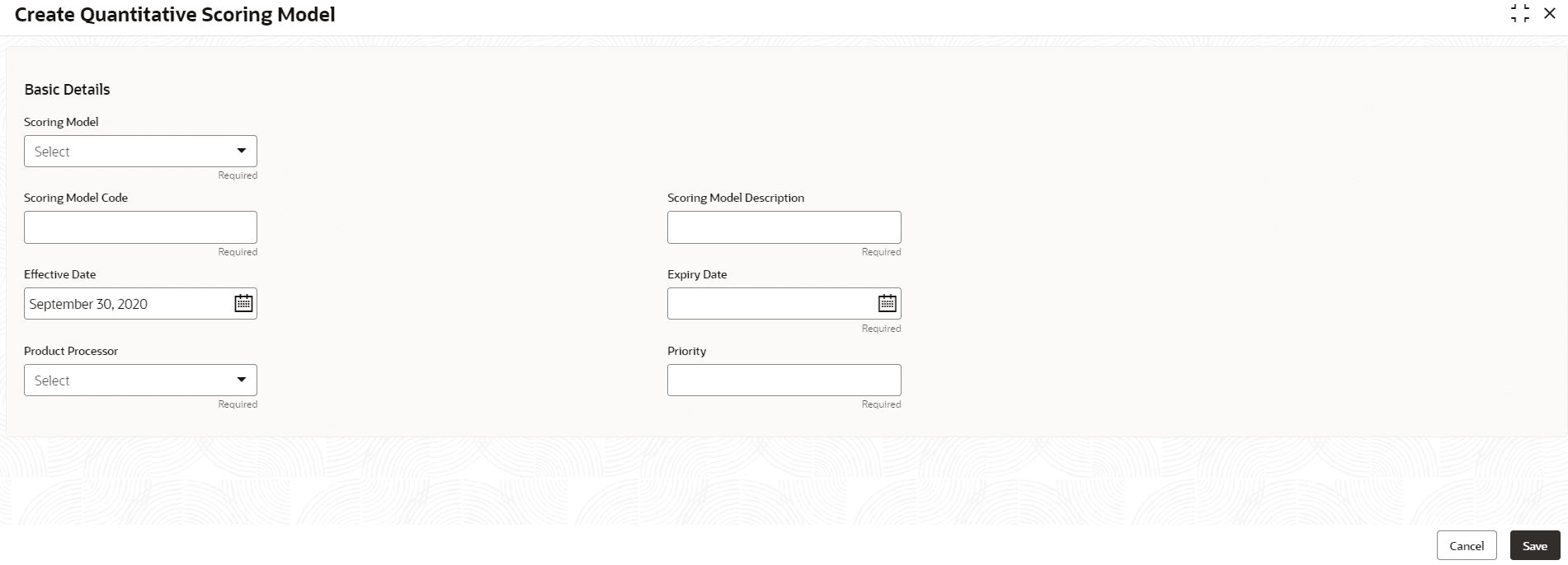

  3. Specify the fields on the Create Quantitative Scoring Model screen.
    The fields marked as Required are mandatory.
    Table 3-32 Create Quantitative Scoring Model - Field Description
    Field Description
    Scoring Model Select the scoring model from the drop-sown list.
    The available options are:
    • Application Scoring Model
    • Applicant Scoring Model
    • Multi-Applicant Scoring Model
    Scoring Model Code Specify the unique scoring model code.
    Scoring Model Description Specify a short description for the scoring model.
    Effective Date Specify the effective date.
    Expiry Date Specify the expiry date.
    Product Processor Specify the product processor for which the model is being created.
    Priority Specify the priority of the model.

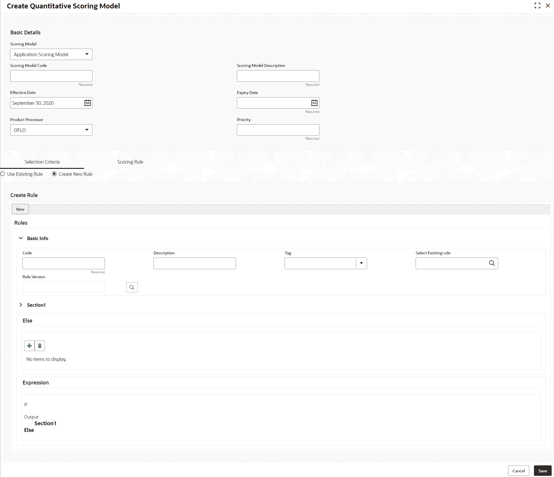

  4. Click the Selection Criteria to define quantitative scoring model.
    The Create Quantitative Scoring Model - Selection Criteria screen is displayed.

    Table 3-33 Create Quantitative Scoring Model - Selection Criteria - Field Description
    Field Description
    Use Existing Rule By default, this option is enabled. Indicates if the existing rule is linked.
    Rule Code Select the rule code from the drop down list.
    Info Click this icon to get the information about the existing rule.
    Rule Name Displays the rule name of the selected rule code.
    Create New Rule Select this option to create new rule.
    Code Specify the rule code.
    Description Specify the rule description.
    + icon Click this icon to add new expression.
    Fact / Rules Select the fact or rule from the drop-down list.
    Once the user selects the fact/rules, one more field opens adjacent to the output, update the same based on the selected output option.
    Operator Select the comparison operator from the drop-down list.
    • Contains
    • In
    • Matches
    • NotMatches
    • NotContains
    • Notin
    Data Type Select the data type for the fact or rule.
    Once the user select the data type, one more field opens adjacent to the output, update the same based on the selected output option.
    • Text
    • Number
    • Boolean
    • Date
    • Fact
    • Rules
    The below option appears if the Data Type is selected as Boolean.
    • True
    • False
    Output Select the output from the drop-down list.
    • Text
    • Number
    • Boolean
    • Date
    • Fact
    • Rules
    • True
    • False
    Expression Displays the expression updated in the expression builder.

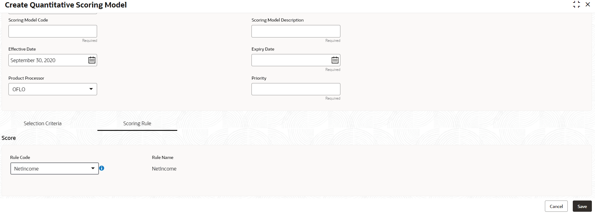

  5. Click the Scoring Rule to define the rules. This tab is enabled if Application Scoring Model is selected.
    The Create Quantitative Scoring Model - Scoring Rule screen is displayed.

    Table 3-34 Create Quantitative Scoring Model - Scoring Rule - Field Description
    Field Description
    Rule Code Select the rule code from the drop-down list.
    Info
    Click this icon to get the information about the rule.
    Rule Name Displays the rule name of the rule code.

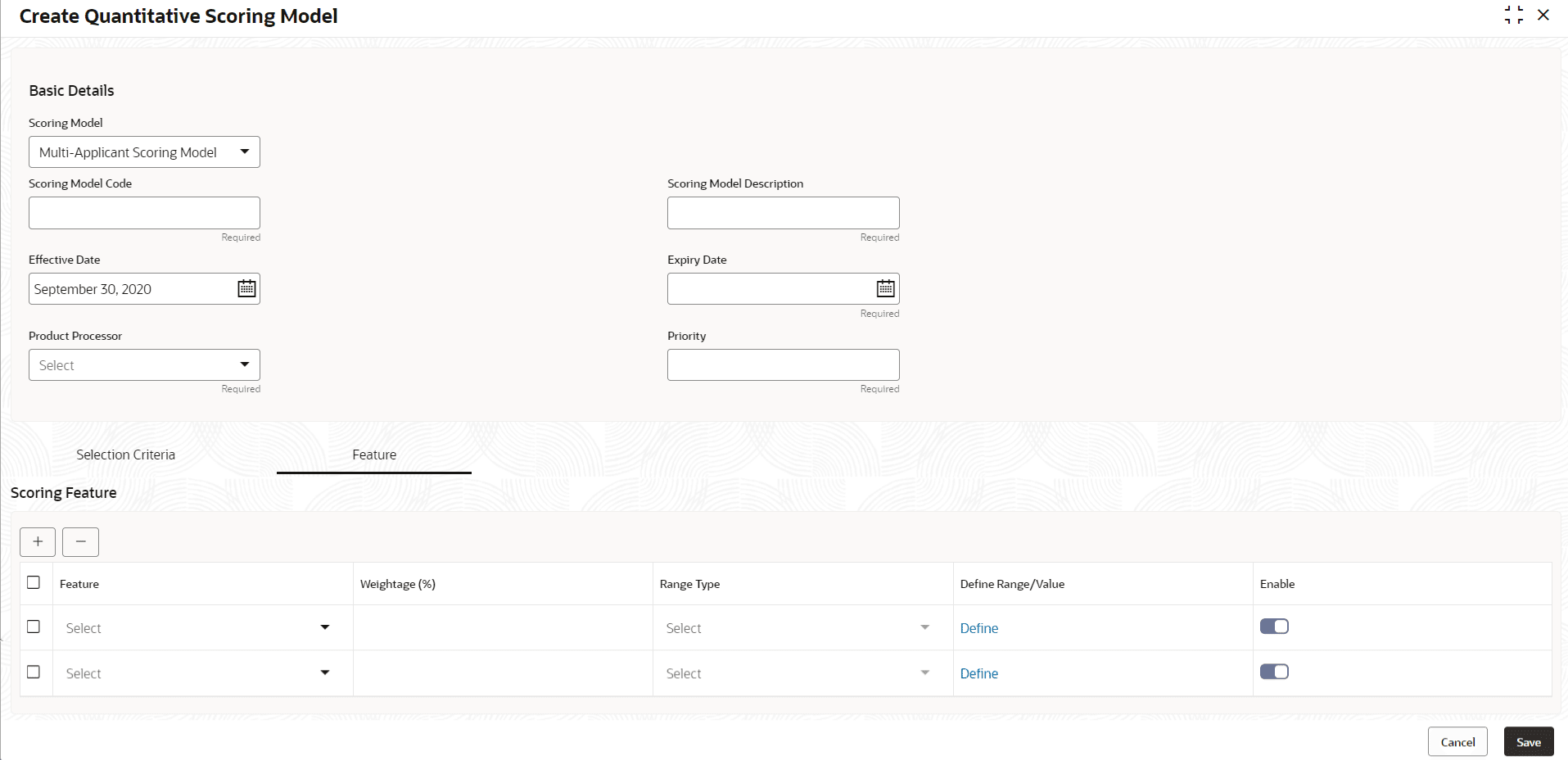

  6. Click the Feature tab to define the feature. This tab is enabled if Applicant Scoring Model and Multiple Applicant Scoring Model is selected.
    The Create Quantitative Scoring Model - Feature screen is displayed.

    Table 3-35 Create Quantitative Scoring Model - Feature - Field Description
    Field Description
    + icon Click this icon to add a new row.
    - icon Click this icon to delete a row, which is already added.
    Feature Select the feature from the drop-down list.
    Weightage (%) Specify the weightage to be assigned to each feature code.
    Range Type
    Select the range type from the drop down list.
    • Max Value
    • Param Percent%
    • Value
    For Applicant Scoring Model, this field is editable.
    Define Range/Value Click the Define link to define the score for the expected response.
    Enable By default, this option is enabled. Indicates if the scoring parameter is enabled or not.

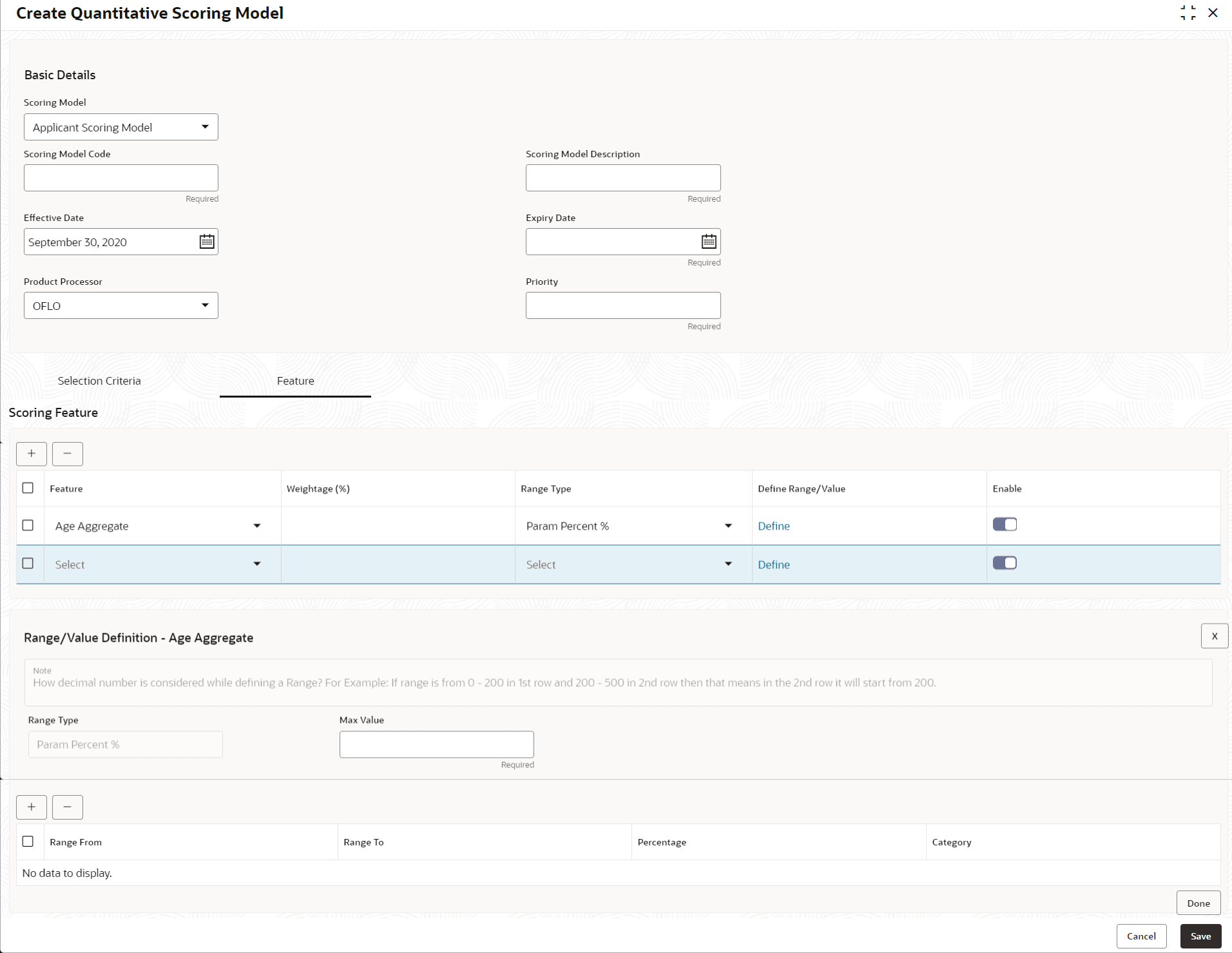

  7. Click the Define link to define a range or absolute values for each scoring feature to be considered for scoring model and score for that range or value.
    In case the data type of feature is numeric such as Bureau score, the Create Quantitative Scoring Model - Define Link - Numeric Feature screen is displayed.

    Table 3-36 Create Quantitative Scoring Model - Define Link – Numeric Feature - Field Description
    Field Description
    Range Type Displays the range type selected.
    Max Value Specify the maximum value on which scoring has to be done, if range type ID is Max Value % or Param %.
    Range From Specify the minimum range of value based on which scoring is to be done.
    Range To Specify the maximum range of value based on which scoring is to be done.
    Score/Percentage
    Specify the percentage to be assigned for each range or value, if range type is Max value % or Param %.
    Specify the score to be assigned for each range or value, if range type is Value.
    Category Specify the category for each range or value from the drop-down list. The values are configurable based on the lookup values maintained.
    • Strong
    • Medium
    • Weak
    The following screen appears when user select an alphanumeric feature data type, such as 'Employment Category'.
    Figure 3-39 Create Quantitative Scoring Model - Define Link –Alphanumeric Feature
    Table 3-37 Create Quantitative Scoring Model - Define Link –Alphanumeric Feature - Field Description
    Field Description
    Range Type Displays the range type selected. The default value for the same is Value.
    Max Value Specify the maximum value for the range type.
    Value Specify the value of the feature.
    Score Specify the score assigned for each range value.
    • Strong
    • Medium
    • Weak
  8. Click Done to save the data and close the range panel.
