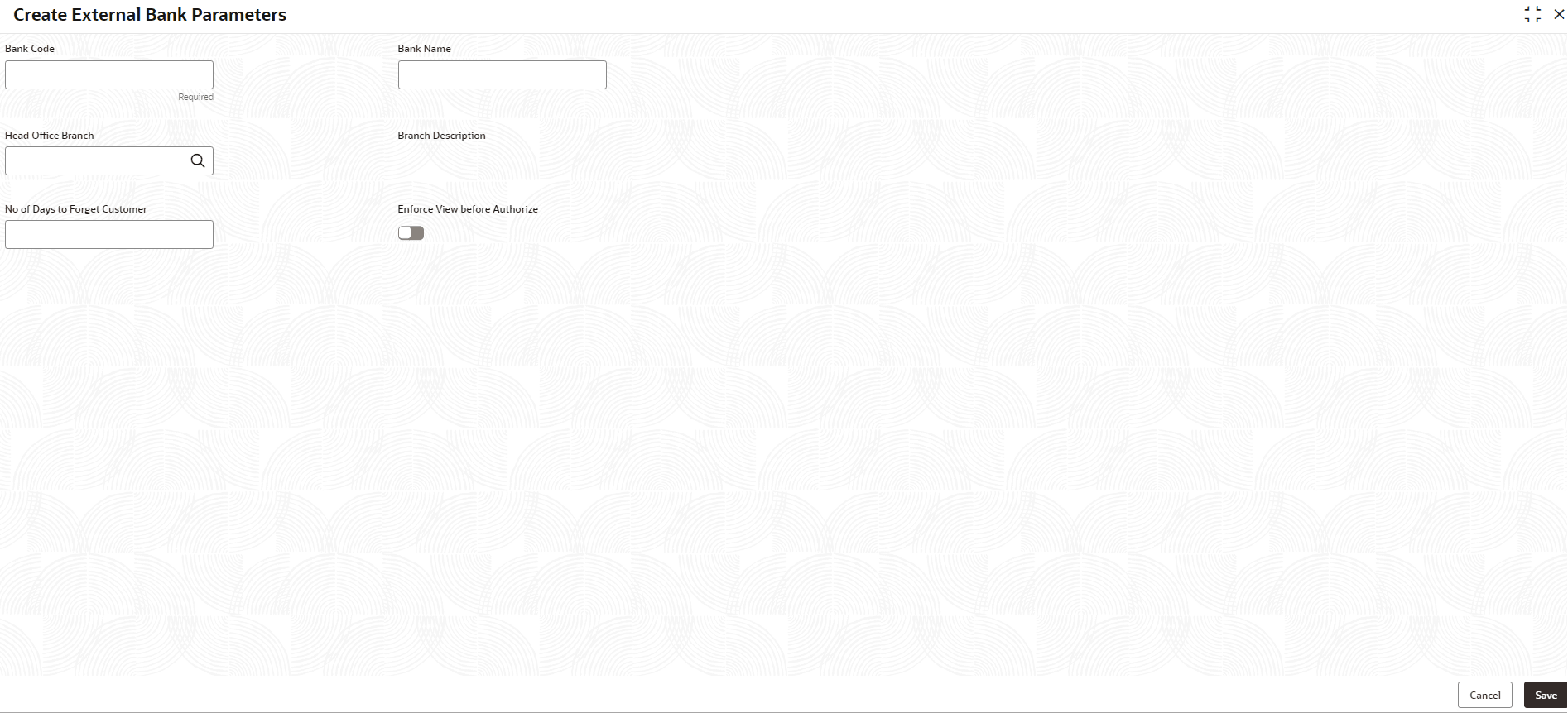

- Under External Bank Parameters, click Create External Bank Parameters.The Create External Bank Parameters screen displays.
Figure 1-44 Create External Bank Parameters
- Specify the fields on Create External Bank Parameters screen.For more information on fields, refer to the field description table.
The fields marked as Required are mandatory.Table 1-44 Create External Bank Parameters – Field Description
Field Description Bank Code Specify the three-digit bank code that uniquely identifies a specific bank within the system. Bank Name Specify the full name of the bank associated with the code provided. Head Office Branch Click this
