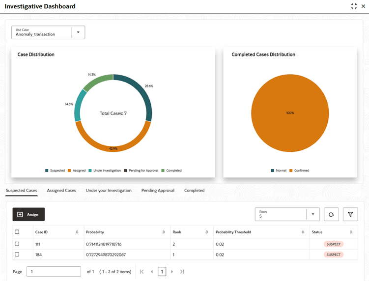

    Figure 5-24 Investigative Dashboard
  2. Select the Use Case to load its cases and metrics.
  3. Review the Case Distribution to view counts across Suspected, Assigned, Under your Investigation, Pending Approval, and Completed.

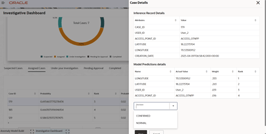

  4. Open Suspected Cases, select the anomaly records, and click Assign to route them to the appropriate owner.

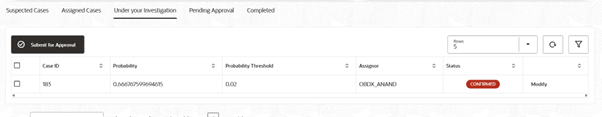

  5. The assignee reviews the case under Under your Investigation, records findings, and sets the outcome as Confirmed or Normal.
  6. 15. After setting the outcome, click Submit for Approval for approval.
