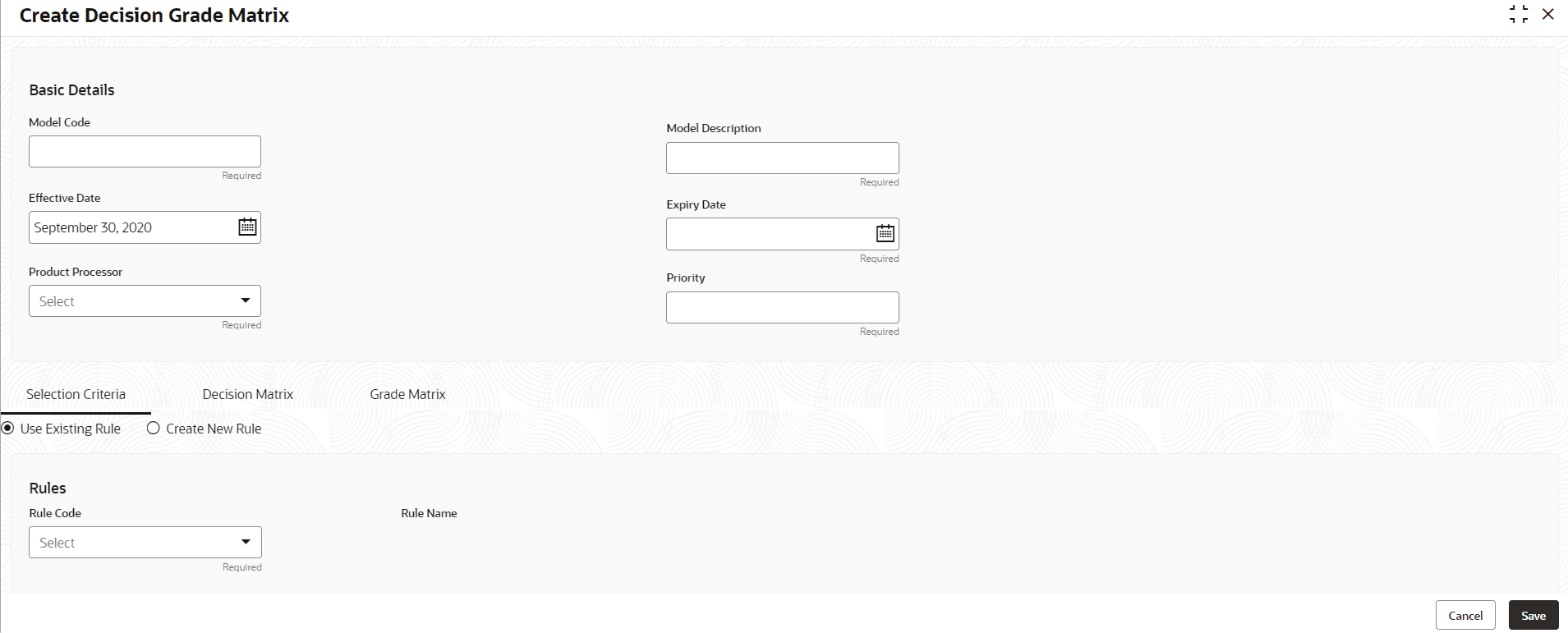

  4. Click the Selection Criteria to configure the parameters based on which decision model is to be resolved.
    The Create Decision Grade Matrix - Selection Criteria screen is displayed.
    Figure 3-46 Create Decision Grade Matrix - Selection Criteria
    Table 3-42 Create Decision Grade Matrix - Selection Criteria - Field Description
    Field Description
    Use Existing Rule By default, this option is enabled. Indicates if the existing rule is linked.
    Rule Code Select the rule code from the drop down list.
    Info Click this icon to get the information about the rule.
    Rule Name Displays the rule name of the rule code.
    Create New Rule Select this option to create new rule.
    + icon Click this icon to add new expression.
    Fact / Rules Select the fact or rule from the drop-down list.
    Once the user selects the fact/rules, one more field opens adjacent to the output, update the same based on the selected output option.
    Operator Select the comparison operator from the drop-down list. The available options are:
    • Contains
    • In
    • Matches
    • NotMatches
    • NotContains
    • Notin
    Data Type Select the data type for the fact or rule.
    Once the user select the data type, one more field opens adjacent to the output, update the same based on the selected output option.
    • Text
    • Number
    • Boolean
    • Date
    • Fact
    • Rules
    The below option appears if the Data Type is selected as Boolean.
    • True
    • False
    Output Select the output from the drop-down list.
    • Text
    • Number
    • Boolean
    • Date
    • Fact
    • Rules
    • True
    • False
    Expression Displays the expression updated in the expression builder.

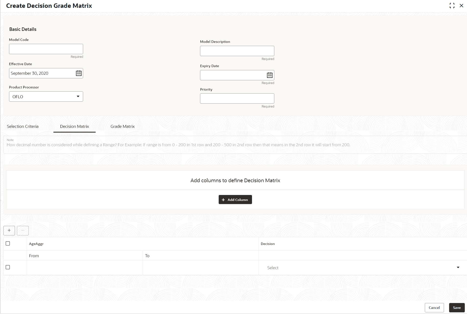

  5. Click the Decision Matrix to define decision on the application. The user can select the feature for which the decision needs to be maintained like Quantitative/Qualitative.
    The Create Decision Grade Matrix - Decision Matrix screen is displayed.
    Figure 3-47 Create Decision Grade Matrix - Decision Matrix
    Table 3-43 Create Decision Grade Matrix - Decision Matrix - Field Description
    Field Description
    Add Column Click this button to add features for which decision has to be maintained.
    On click of Add Column, all the features are shown in the drop down list. Select the feature to be added. Click save to add the feature.
    If the feature is numeric type, two columns gets added in the table From and To. If the feature is character/alphanumeric type one column Value gets added.
    System should not save, if no feature have been added. User can click Cancel to close the window.
    Link a Rule? Select the appropriate radio button to link a rule to the features.
    The options are:
    • Yes - If this option is selected, the system displays the list of rules. Based on the rule mapped, the decision is provided.
    • No - If this option is selected, the system displays the list of decision lookup values.
    + icon Click this icon to add a new row.
    - icon Click this icon to delete a row, which is already added.
    Score From Specify the minimum range of score for the decision.
    Score To Specify the maximum range of score for the decision.
    Decision Specify the decision of an application from the drop-down list.
    The values are configurable based on the look up values maintained
    • Approved
    • Manual
    • Rejected
    Rule Displays the rules based on which decision is to be made.
    This field is enabled if Link a Rule? option is updated as Yes.

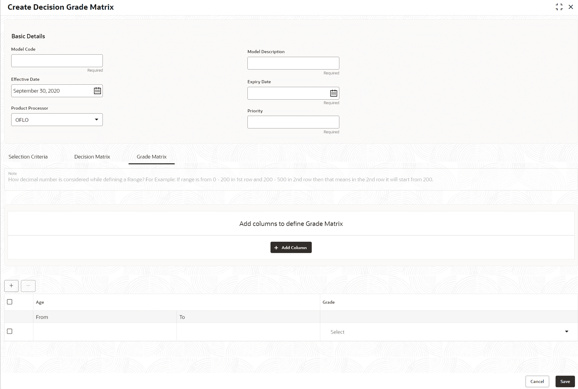

  6. Click the Grade Matrix to assign the grade to the application that is used during the pricing of the application. You can select the feature for which the grade needs to be maintained like Quantitative/Qualitative.
    The Create Decision Grade Matrix - Grade Matrix screen is displayed.
    Figure 3-48 Create Decision Grade Matrix - Grade Matrix
    Table 3-44 Create Decision Grade Matrix - Grade Matrix - Field Description
    Field Description
    Add Column Click Add Column, for addition of features for which decision has to be maintained.
    The options are:
    Delete Click this icon to delete a column, which is already added.
    Score From Specify the minimum range of score for the grade.
    Score To Specify the maximum range of score for the grade.
    Grade Specify the grade of the application based on the score scored. The values are configurable based on the look up values maintained.
    • A
    • B
    • C
    Value Specify the value for which the grade has to be maintained.
    This field appears only if the data type of feature is Numeric such as Age, FICO score.
