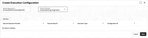

    The Create Execution Configuration screen is displayed.
    Figure 3-153 Create Execution Configuration
  3. Specify the fields on the Create Execution Configuration screen.
    The fields marked as Required are mandatory.
    Table 3-124 Create Execution Configuration - Field Description
    Field Description
    Execute Sequence ID Specify the unique execute sequence ID.
    Product Processor Select the product processor from the drop-down list for which configuration is being created.
    Execute Sequence Number Specify the unique sequence number for the execute sequence table.
    Execute Step ID Specify the unique step ID for the execute sequence table.
    Execution Type Select the type from the drop-down list.
    The available options are:
    • Parse
    • Retrieve
    • Store

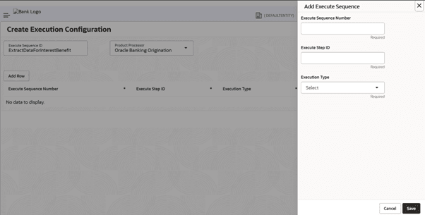

  4. On the Add Execute Sequence screen, select the execution type to maintain the configuration.
