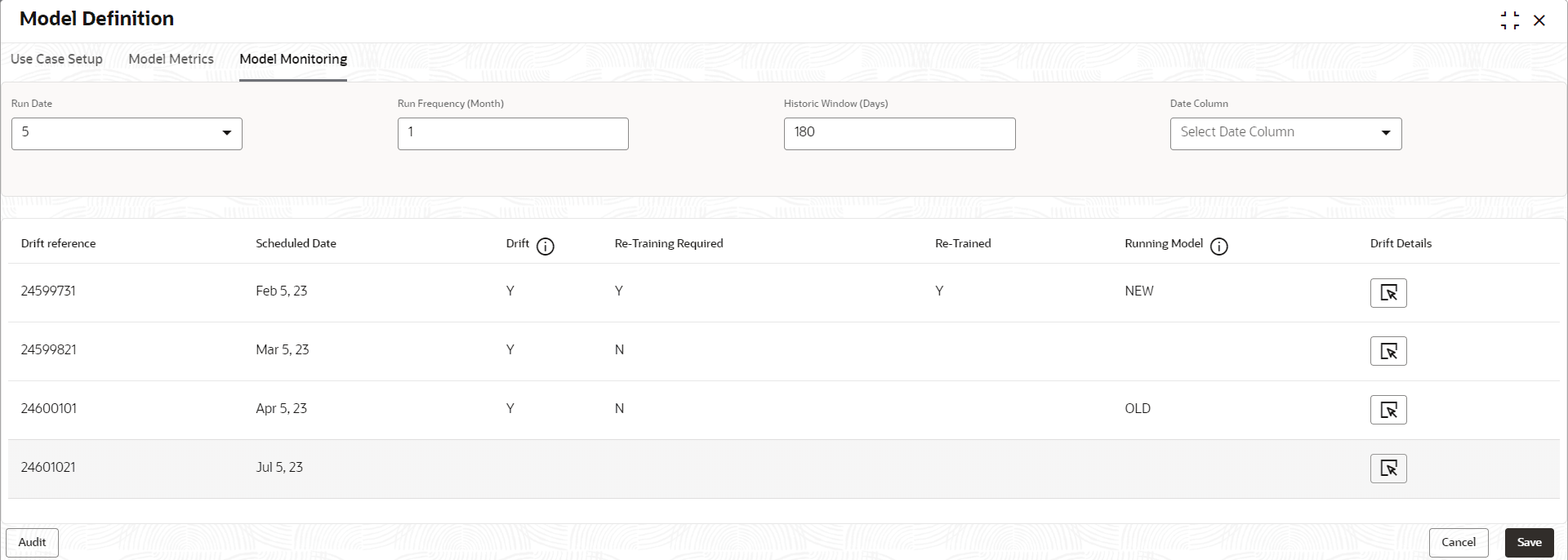

  4. Select Model Monitoring tab in the Model Definition screen.
    The Model Monitoring screen is displayed.
  5. This screen allows you to setup Model monitoring for the use case.
    Table 5-18 Model Monitoring – Field Description
    Field Description
    Run Case Run date is the calendar date used with ‘Run Frequency (Month)’ to set up a recurring monitoring schedule. On the schedule date, model monitoring routine will analyze the underlying data to detect presence/absence of data drift and trigger model re-build.
    Permissible values: 1 – 31 and default is 15
    Note: This field is mandatory but will be disabled for Anomaly Detection.
    Specify the run frequency in months.
    Example: if we want to schedule a run on 17th of every 6 months, then we set up
    Run Date: 17
    Run Frequency (Month): 6
    6 is the set default, the value. Minimum value is 1
    Historic Window (Days)
    Historic window in days determine how far back should we consider, to define the window of data evaluation.
    Example: A value of 90 would mean a historic window from T-90 days to T Day, T being the system date. Default is set at 180.
    Note: This field is mandatory.
    Date Column This field captures the date column in the data source which should be considered for determining the historic window. Keep it empty If the data source does not have a date column.
    In the absence of a date column in the data source, system will consider the entire available data available in the data source.
  6. The following fields are populated for reference once the model monitoring routine is executed on the scheduled date.
    Table 5-19 Model Evaluation - Field Description
    Field Description
    Drift Reference Displays the Unique Drift Reference ID, populated by the model monitoring routine initial run
    Scheduled Date Displays the scheduled date after the initial run of the model monitoring routine.
    Drift Initially it will be empty and will get populated once the model monitoring routine runs and determines the presence or absence of drift. Display value is Y or N.
    Re-Training Required Model monitoring routine determines the re-training requirement and populates Y or N values.
    Re-Trained Model monitoring routine populates the status of re-training with Y or N values.
    Running Model The model monitoring routine evaluates both the existing and the new model, it re-trained, to determine which model best fits the contemporary changed data. Final values are OLD, if existing model is retained or NEW, for revised re-trained model.

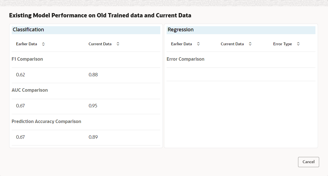

  8. Select the relevant Drift Reference record.
    Click Info from Drift header to view the comparative Model Performance Screen to understand how the decision of drift is arrived at.
    Existing model is used to predict on an earlier data sample and the current data sample. The results of both the prediction are captured and displayed.
    Classification models are compared on F1, AUC and Prediction accuracy while Regression, models are evaluated on prediction error.
    Figure 5-16 Existing Model Performance on Old Trained data and Current Data

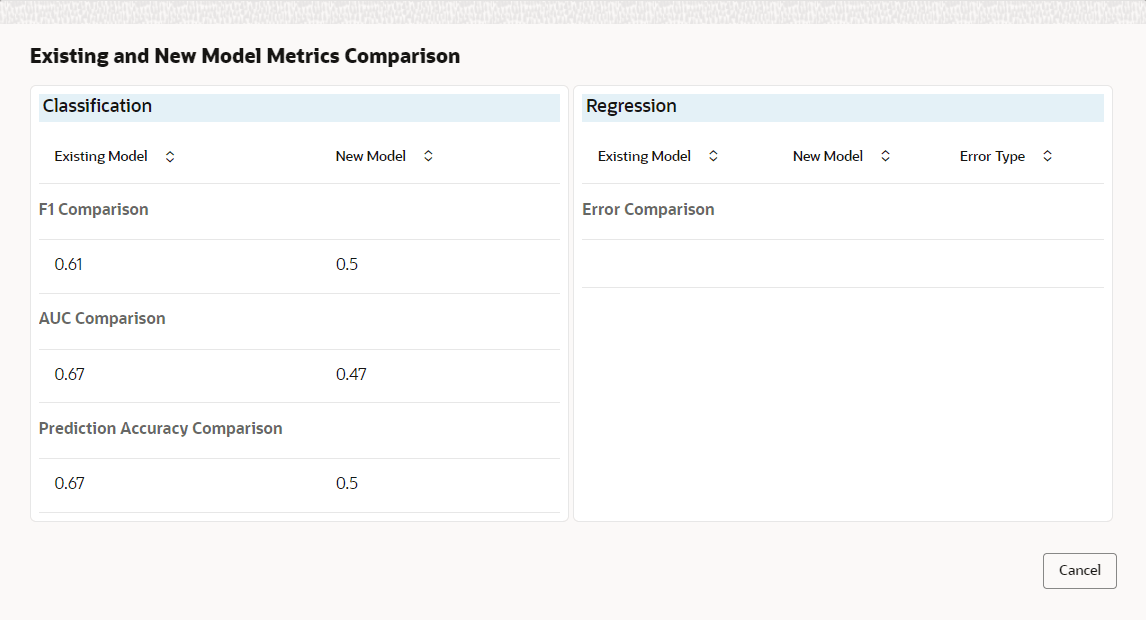

    Click Info from Running Model header to view the comparative performance of the re-trained model vs current model, in order to understand how the system decided on which model best fit the current data distribution.
    Classification models are evaluated on F1, AUC and Prediction accuracy while Regression models, are evaluated on prediction error.
    Figure 5-17 Existing and New Model Metrics Comparison
