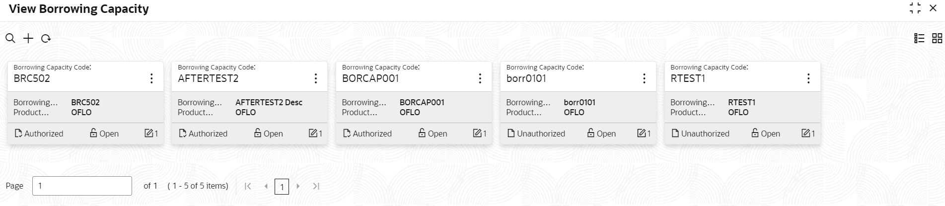

  3. On the View Borrowing Capacity screen, click Search icon.
    The View Borrowing Capacity - Search screen is displayed.

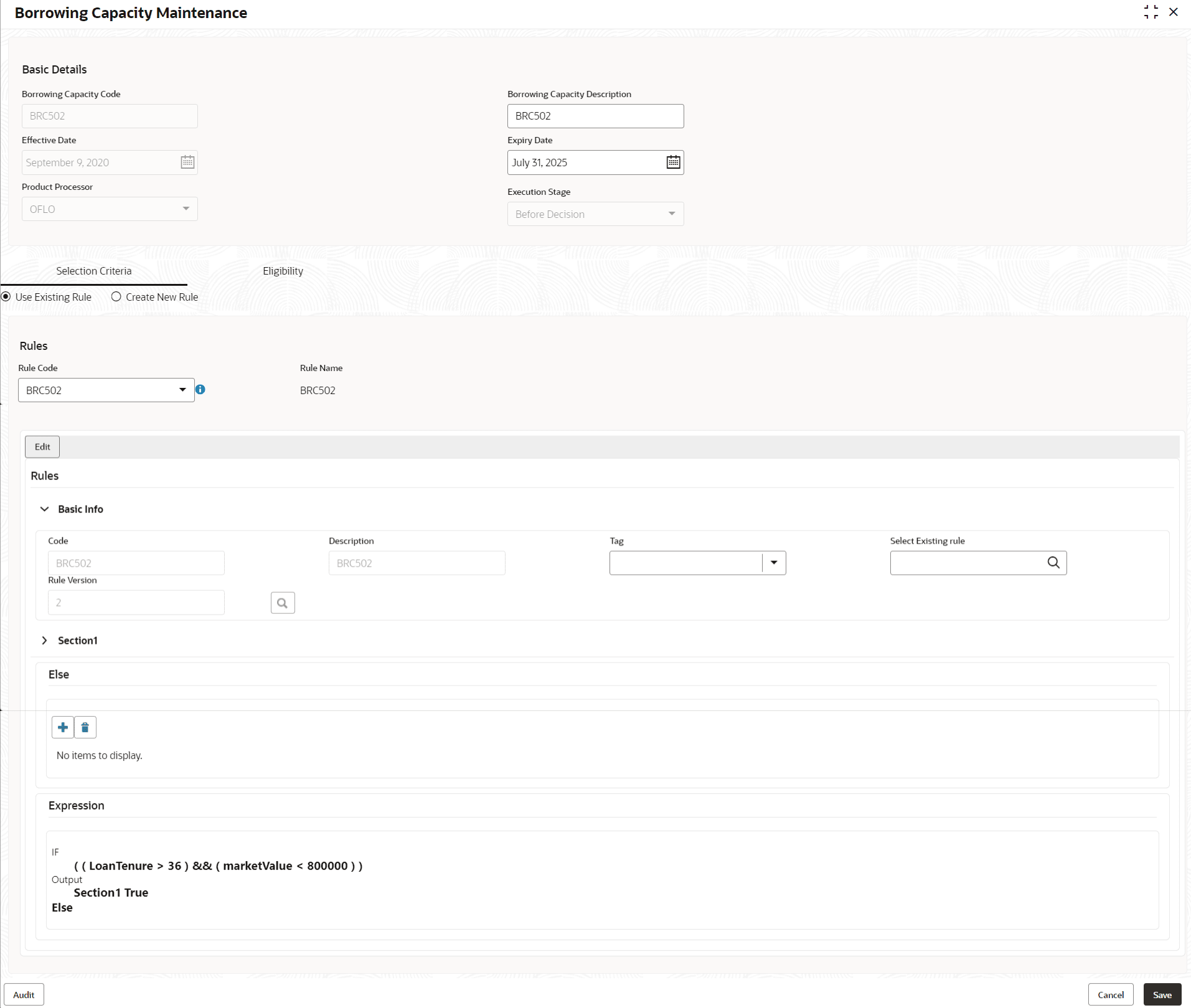

  7. Click Unlock to modify the borrowing capacity.
    The Borrowing Capacity Maintenance - Modify screen is displayed.
    Figure 3-25 Borrowing Capacity Maintenance - Modify
    The fields marked as Required are mandatory.
    Table 3-21 Borrowing Capacity Maintenance - Modify - Field Description
    Field Description
    Borrowing Capacity Code Displays the model code for the created borrowing capacity.
    Borrowing Capacity Description The user can modify the model description for the created borrowing capacity.
    Effective Date The user can modify effective date for the borrowing capacity.
    Expiry Date The user can modify date of the created borrowing capacity.
    Product Processor Displays the product processor for the borrowing capacity.
    Execution Stage Displays execution stage for the borrowing capacity.
    Use Existing Rule
    Indicates if the existing rule is linked.
    Rule Code
    The user can modify the rule code for the created borrowing capacity.
    Info Click this icon to get the information about the rule.
    Rule Name Displays the rule name of the rule code for the created borrowing capacity.
    Create New Rule
    Code Specify the new rule code for borrowing capacity.
    Description Specify the rule description for the borrowing capacity.
    Fact / Rules Displays the fact or rule for the created borrowing capacity.
    Operator Displays the comparison operator for the created borrowing capacity.
    Data Type Displays the data type for the fact or rule for the created borrowing capacity.
    Output Displays the output for the created borrowing capacity.
    Expression Displays the expression updated in the expression builder for the created borrowing capacity.
    Fact ID The user can modify the fact ID of the created borrowing capacity.
    Rule ID The user can modify the rule ID of the created borrowing capacity.
  8. Click Save to save the details.

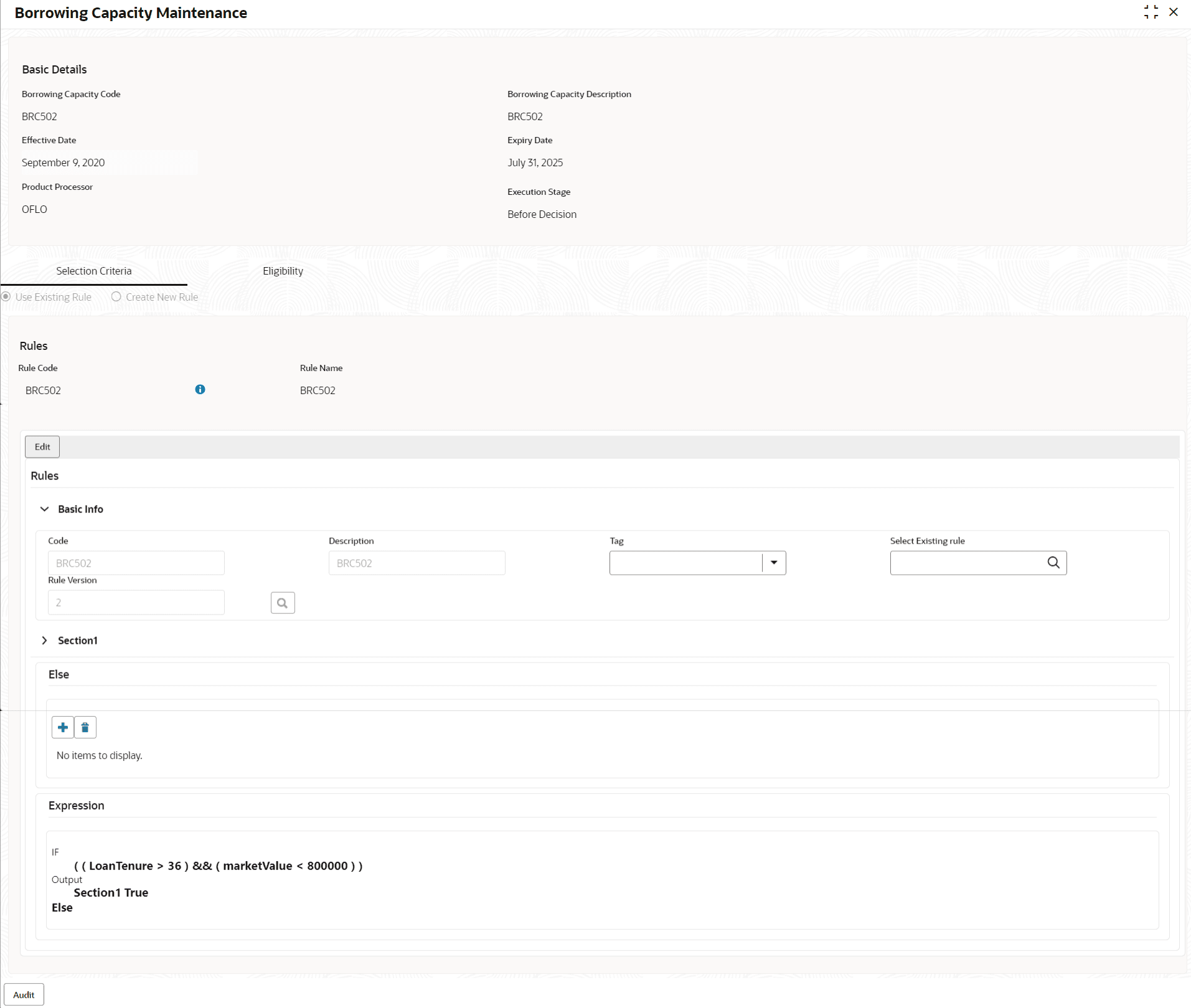

  9. Click View to view the borrowing capacity.
    The Borrowing Capacity Maintenance – View screen is displayed.
    Figure 3-26 Borrowing Capacity Maintenance – View
    Table 3-22 Borrowing Capacity Maintenance - View - Field Description
    Field Description
    Borrowing Capacity Description Displays the model description for the created borrowing capacity.
    Effective Date Displays effective date for the borrowing capacity.
    Expiry Date Displays date of the created borrowing capacity.
    Use Existing Rule
    Rule Code
    Displays the rule code for the created borrowing capacity.
    Create New Rule
    Code Displays the rule code for borrowing capacity.
    Description Displays the rule description for the borrowing capacity.
    Fact ID Displays the fact ID of the created borrowing capacity.
    Rule ID Displays the rule ID of the created borrowing capacity.
