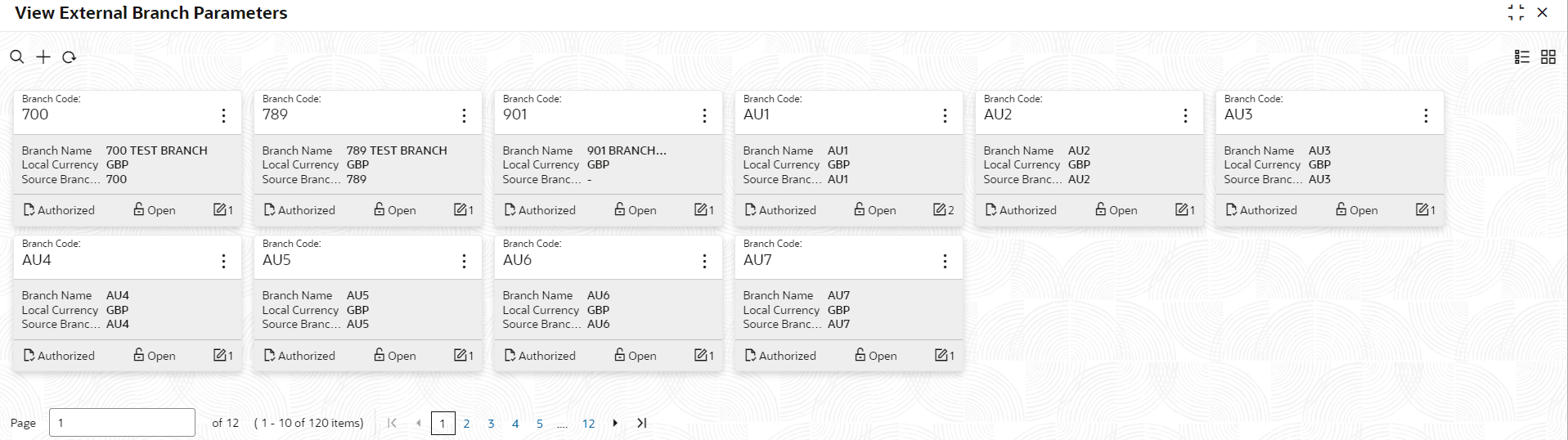

  2. Under External Branch Parameters, click View External Branch Parameters.
    The View External Branch Parameters screen is displayed.
    Figure 1-53 View External Branch Parameters
    Table 1-52 View External Branch Parameters – Field Description
    Field Description
    Branch Code Displays the code of the bank.
    Branch Name Displays the name of the bank.
    Local Currency Displays the local currency details.
    Source Branch Code Displays the code of the source branch.
    Authorization Status Displays the authorization status of the record.
    The options are:
    • Authorized
    • Rejected
    • Unauthorized
    Record Status Displays the status of the record.
    The options are:
    • Open
    • Closed
    Modification Number Displays the number of modification performed on the record.
