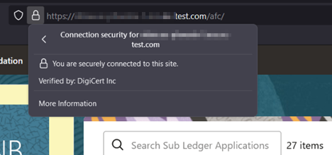

  1. Log in to the AFCS Application.
  2. Click the View site information/Verified by verified_by Icon in the Browser URL Address Bar.
  3. Select More information.
    Figure 3-1 Certificates - More information
    More information certificate
