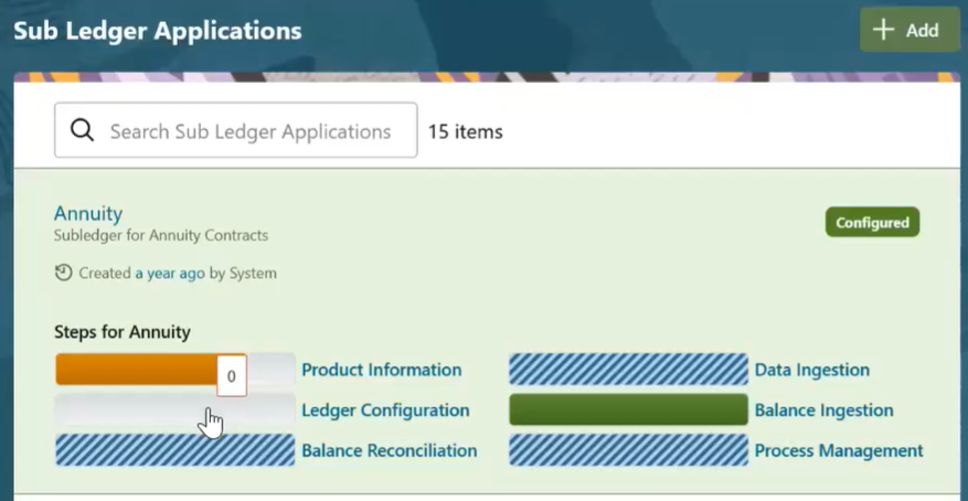

- Click the bar next to Ledger Configuration
to launch the configuration UI. At this point, the ledger
configuration is shown as 0%.

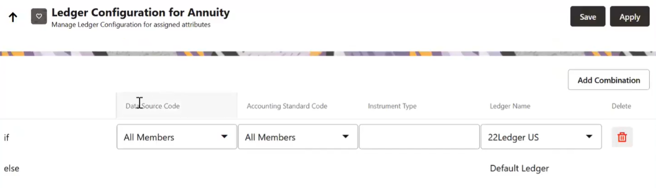

- On the Ledger Configuration UI, select or
enter values for the attributes for the first combination.

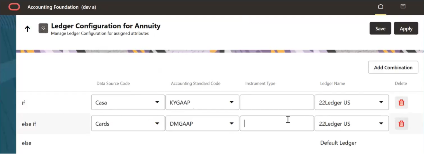

- Click Add Combination and enter values for
attributes for the second combination.
You can select a maximum of 30 attributes per combination and an unlimited number of combinations.
Figure 10-5 Subledger Configuration for Annuity_step 3

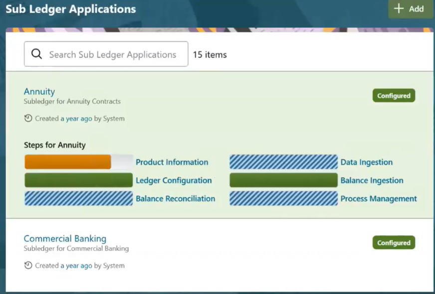

- In the Sub Ledger Applications summary page, Ledger Configuration status is shown as 50% for this SLA.
- If you are a member of the AFCSAPVRGRP, you can click Apply to apply the changes. While the changes are being applied, ledger configuration status is shown as 75%.
- After all the changes are applied, the ledger configuration status
shows 100%.
