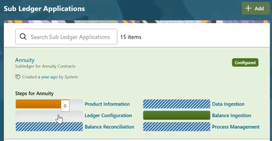

  1. Click the bar next to Ledger Configuration to launch the configuration UI. At this point, the ledger configuration is shown as 0%.
    Figure 10-3 Subledger Configuration for Annuity_ step 1

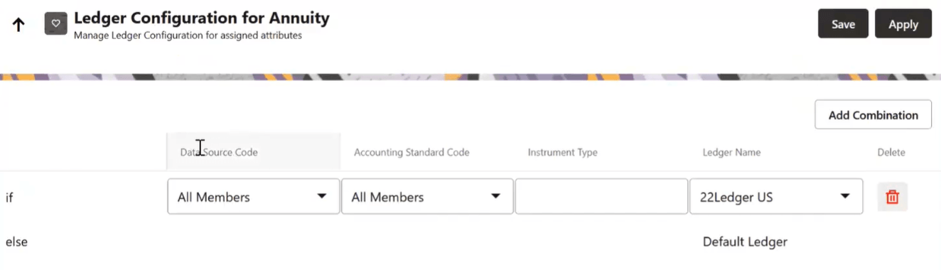

  2. On the Ledger Configuration UI, select or enter values for the attributes for the first combination.
    Figure 10-4 Subledger Configuration for Annuity_step 2
    This image displays Subledger Configuration for Annuity_step 2.

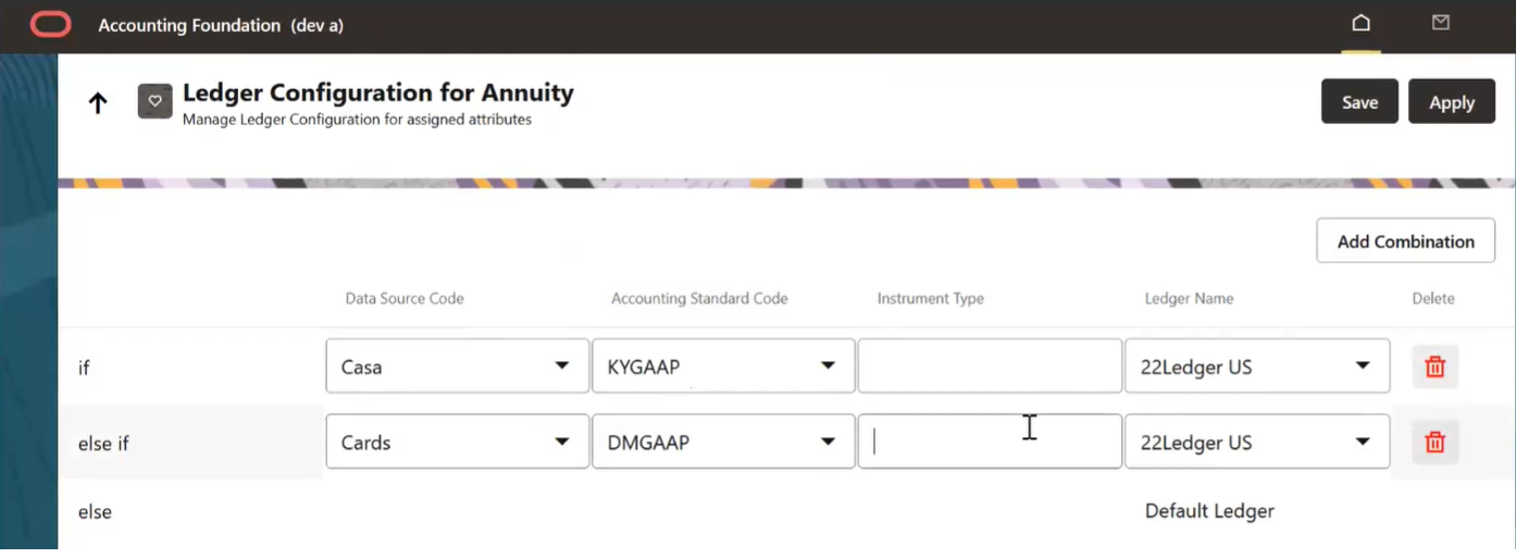

  3. Click Add Combination and enter values for attributes for the second combination.
    You can select a maximum of 30 attributes per combination and an unlimited number of combinations.
    Figure 10-5 Subledger Configuration for Annuity_step 3
    This image displays Subledger Configuration for Annuity_step 3.
  4. Repeat step 3 for as many combinations as you require.

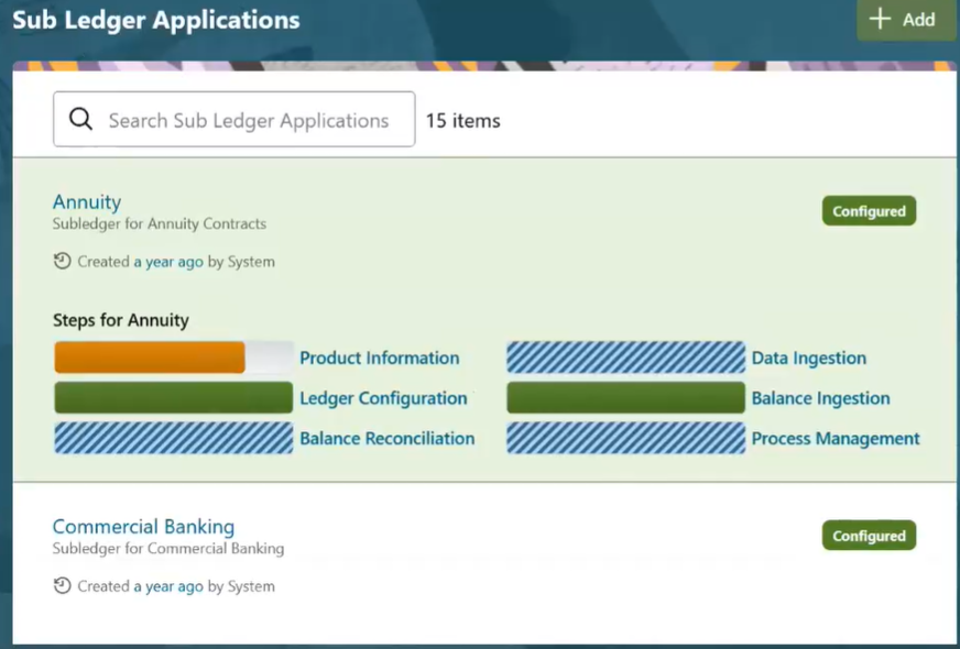

  6. In the Sub Ledger Applications summary page, Ledger Configuration status is shown as 50% for this SLA.
  7. If you are a member of the AFCSAPVRGRP, you can click Apply to apply the changes. While the changes are being applied, ledger configuration status is shown as 75%.
  8. After all the changes are applied, the ledger configuration status shows 100%.
