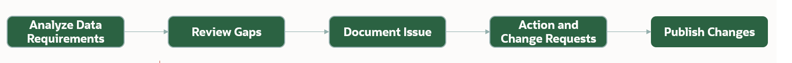

6.1 Catalog Extension Process Workflow
The catalog extension process workflow is as follows:
Figure 6-1 Catalog Extension Process Workflow
