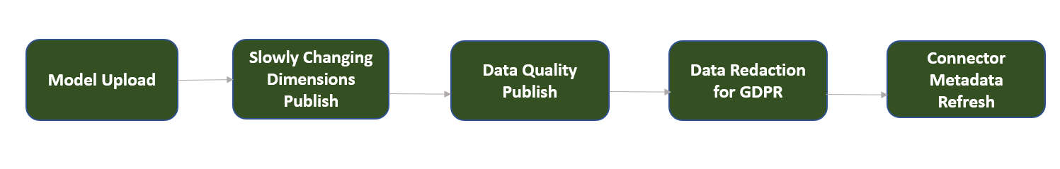

Figure 6-2 Publish Change Request Process Workflow
The following image is an illustration of the change request process
  • Model Upload
    • The Data catalog extension generates a model artifact in the Object store.
    • The Physicalization of the above model and the object registration will be performed in the system.
  • Slowly Changing Dimensions Publish
    • The Slowly Changing Dimensions (SCD) definition of new entities that are part of the model are registered with the system.
  • Data Quality Publish
    • The Data Quality definition of new entities that are part of the model are registered with the system.
  • Data Redaction for GDPR
    • Any PII attribute part of the Data catalog extension model is implicitly eligible for the redaction which safe guards the data against any unauthorized access and the data theft.
  • Connector Metadata Refresh (ADI Refresh)
    • This reads the data catalog extension model uploaded in the system and creates ADIs.
    • This is a mandatory activity for any model change.
Steps are automated and internal while triggering publish process.
