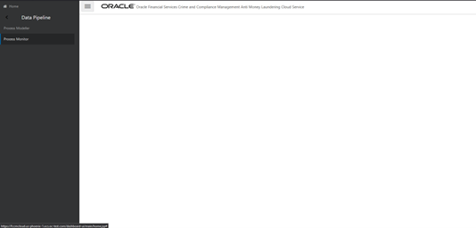

- After PMF Execution, from the main window, select Process Monitor:

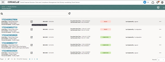

- Click Launch Process in New Window icon open in a new tab:

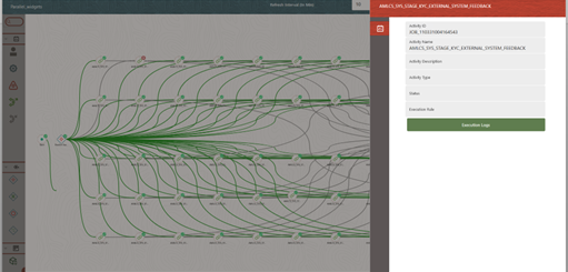

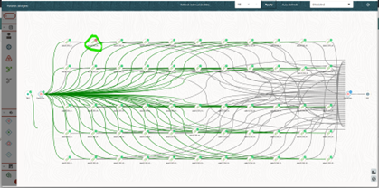

- Double click on the failed widget to view logs:

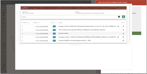

- Click Execution Logs
- The Log Viewer window shows the log messages.
