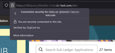

- Log in to the AFCS Application.
- Click the View site information/Verified by
Icon in the Browser URL Address Bar.
- Select More information.
Figure 4-1 Certificates - More information
