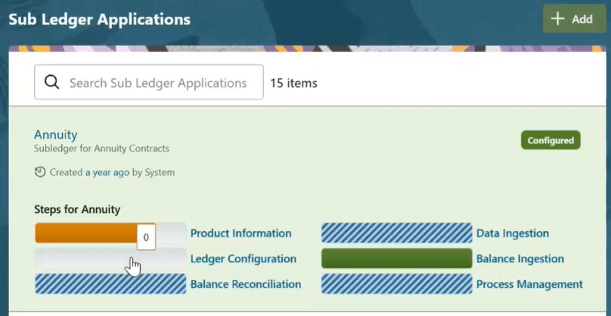

  1. Click the bar next to Ledger Configuration to launch the configuration UI. At this point, the ledger configuration is shown as 0%.
    Figure 13-3 Subledger Configuration for Annuity_ step 1

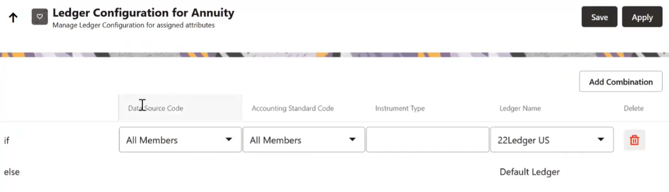

  2. On the Ledger Configuration UI, select or enter values for the attributes for the first combination.

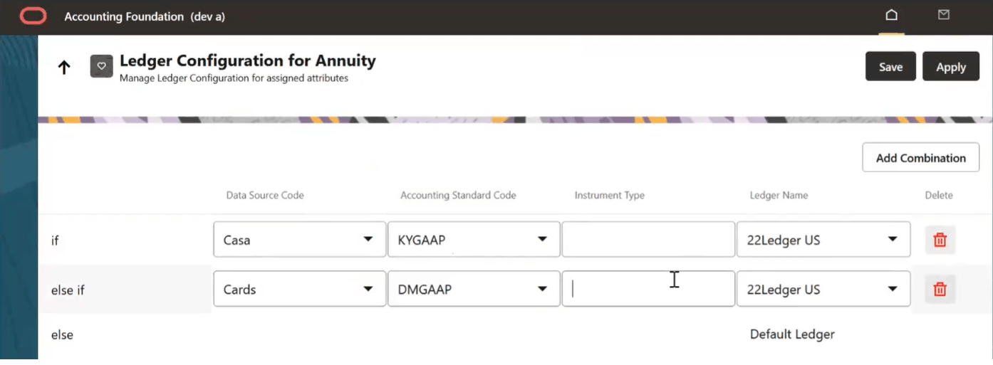

  3. Click Add Combination and enter values for attributes for the second combination.
    You can select a maximum of 30 attributes per combination and an unlimited number of combinations.

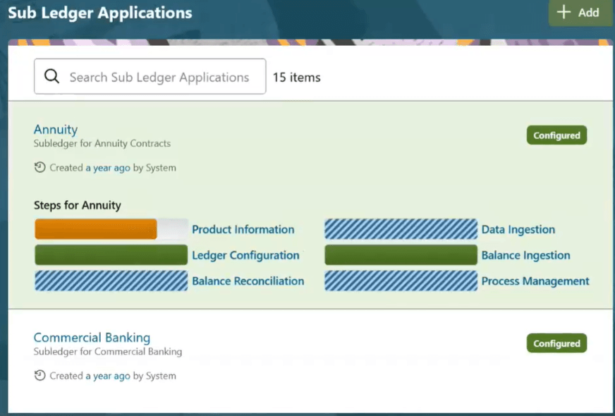

  6. In the Sub Ledger Applications summary page, Ledger Configuration status is shown as 50% for this SLA.
  7. If you are a member of the AFCSAPVRGRP, you can click Apply to apply the changes. While the changes are being applied, ledger configuration status is shown as 75%.
  8. After all the changes are applied, the ledger configuration status shows 100%.
