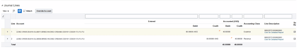

  • Follow ERP user documentation to perform configuration and extension to ‘View Journal Entry’ user interface.

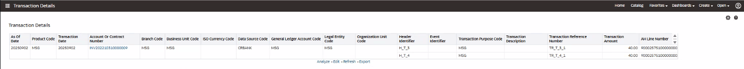

  • The URL will navigate to AFCS Oracle Analytics report that lists the sourced transactions information.
    This URL needs to be invoked from ERP Cloud FAH user interface with Journal line number as the parameter.
Figure 23-5 ERP Journal Lines Details
Figure 23-6 AFCS Transaction Details Report
