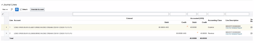

The Drill Down capability enables users to trace a grouped journal line in Accounting Hub back to the AFCS Reclassification Events that created it. From the Accounting Hub Grouped Journal Line, select the journal line number to begin drill down. The AFCS Transaction Details report opens, filtered to the selected journal line number. The report displays the underlying AFCS Reclassification Events, providing traceability from the Accounting Hub journal to its source events. This helps users investigate journals and confirm the activity supporting a journal line.
Figure 22-7 ERP Journal Lines Details

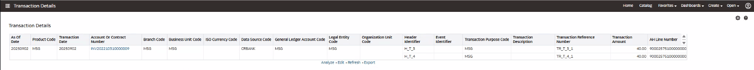

Figure 22-8 AFCS Transaction Details Report
