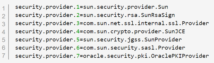

DBAAIB =(DESCRIPTION =(ADDRESS = (PROTOCOL = TCPS)(HOST = dbsrvhostname.in.oracle.com)(PORT = 2484))(CONNECT_DATA =(SERVER = DEDICATED)(SERVICE_NAME = DBAAIB))(security=(ssl_server_cert_dn= "CN=dbsrvhostname")))dbtyofsaaatm =(DESCRIPTION =(ADDRESS = (PROTOCOL = TCPS)(HOST = dbsrvhostname.in.oracle.com)(PORT = 2484))(CONNECT_DATA=(SERVER = DEDICATED)(SERVICE_NAME=DBAAIB))(security=(ssl_server_cert_dn= "CN=dbsrvhostname")))CONFIG = (DESCRIPTION = (ADDRESS = (PROTOCOL = TCPS)(HOST = dbsrvhostname.in.oracle.com)(PORT = 2484) ) (CONNECT_DATA = (SERVER = DEDICATED) (SERVICE_NAME = DBAAIB) )(security=(ssl_server_cert_dn= "CN=dbsrvhostname")) )SYS = (DESCRIPTION = (ADDRESS = (PROTOCOL = TCPS)(HOST = dbsrvhostname.in.oracle.com)(PORT = 2484) ) (CONNECT_DATA= (SERVER = DEDICATED) (SERVICE_NAME=DBAAIB) )(security=(ssl_server_cert_dn= "CN=dbsrvhostname")) ) - Enable Java Security Provider as Oracle PKI Provider statically on machines
hosting OFSAA and the Web Application Servers, by performing the following
step:
- Since SSO wallets (cwallet.sso) are used, add the OraclePKIProvider at
the end of the provider list in the java.security file (this file is
part of your JRE install located at
$JRE_HOME/jre/lib/security/java.security) which typically looks like:
Figure 13-1 JRE install located in the Java.Security file
