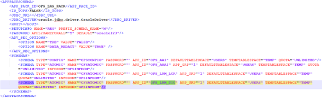

To configure the <APP PACK>_SCHEMA_IN.xml
file:
- Log in to the system as a non-root user.
- Navigate to the
<APP PACK>/schema_creator/conf
directory and configure the<APP PACK>_SCHEMA_IN.xml
file based on the following parameters.Figure 7-2 Sample OFS_LRS_SCHEMA_IN.xml File
- Save the file.
On successful execution of the utility, the passwords entered in the OFS_LRS_SCHEMA_IN.xml file are nullified.Table 7-2
